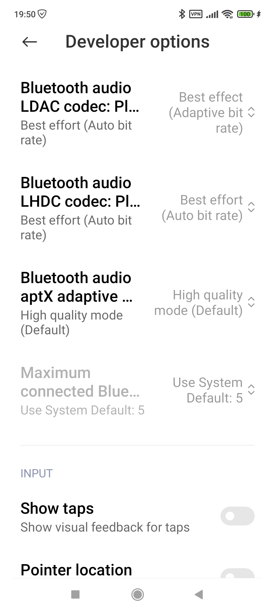

See configuration of quality for aptx adaptive (developers mode)
Can't say in 100% certainty as my smartphone only has the vanilla flavor 24/48 aptx Adaptive, though in theory it should. aptx Adptive is different to any other codec in that it is an automatic scalable codec. It will go to the best possible quality if you have a very good BT connection then automatically and dynamically scale down to improve BT stability when BT connection is weak.Can I assume that the Go Blu set to aptx adaptive with 888SoC phone (set to high quality in developers mode) provides similar audio quality as ldac or lhdc set to highest bandwidth (~900 kbs)?
Thanks
