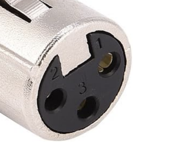

I'm running single ended tt2 into my kef metas speakers with great results. I want to connect a d110 jl audio powered subwoofer from the tt2 using two xlr to rca cables. Is it simply a matter of using any 2 x 3 pole female xlr connectors? I've never used xlr before so this is new territory for me.
I've been given this advice by Rob:
use pins 1 (gnd) and pins 2 (hot or signal).
so will any xlr connector numbered as follows work?
Nov 3, 2023 at 7:55 AM Post #18,178 of 19,749
Those are the standard numberings on all xlr plugs and sockets.
The way they are used depends on the specific device and/or cable.
I think Rob was just confirming how the pins are used on the tt2 xlr output, which is in accord with the usual convention and which I assume is pin 1 for ground, pin 2 for signal +ve, and pin 3 for signal -ve.
What you have to do is to ensure that the cable and other device that you use are wired so the pin usage agrees with how the tt2 uses them ie its "pinout" - otherwise you will have a (possibly hot) mess.
Nov 3, 2023 at 8:32 AM Post #18,179 of 19,749
If i'm using 2 xlr to rca cables from tt2 to line level right and left in on sub how do i go about doing this?
I've spent a fair while reading about xlr connections online but i cant physically visualise what to actually do.
I know that pins 1 (gnd) and pins 2 (hot or signal) is what i'm aiming for. Can anyone simplify this for me?
I've read back through the forum and so is it a simple question of ordering a dual 3 pin female XLR "Y" connector to rca cable? A member used that to connect tt2 to his abyss headphones.
Nov 3, 2023 at 8:57 AM Post #18,180 of 19,749
That kind of cable should do as long as it is twin 3-pin xlr to twin rca.
However, should you see a future with two subs then a pair of 3-pin xlr to single rca cables would be the same but could be used in that future as well.
