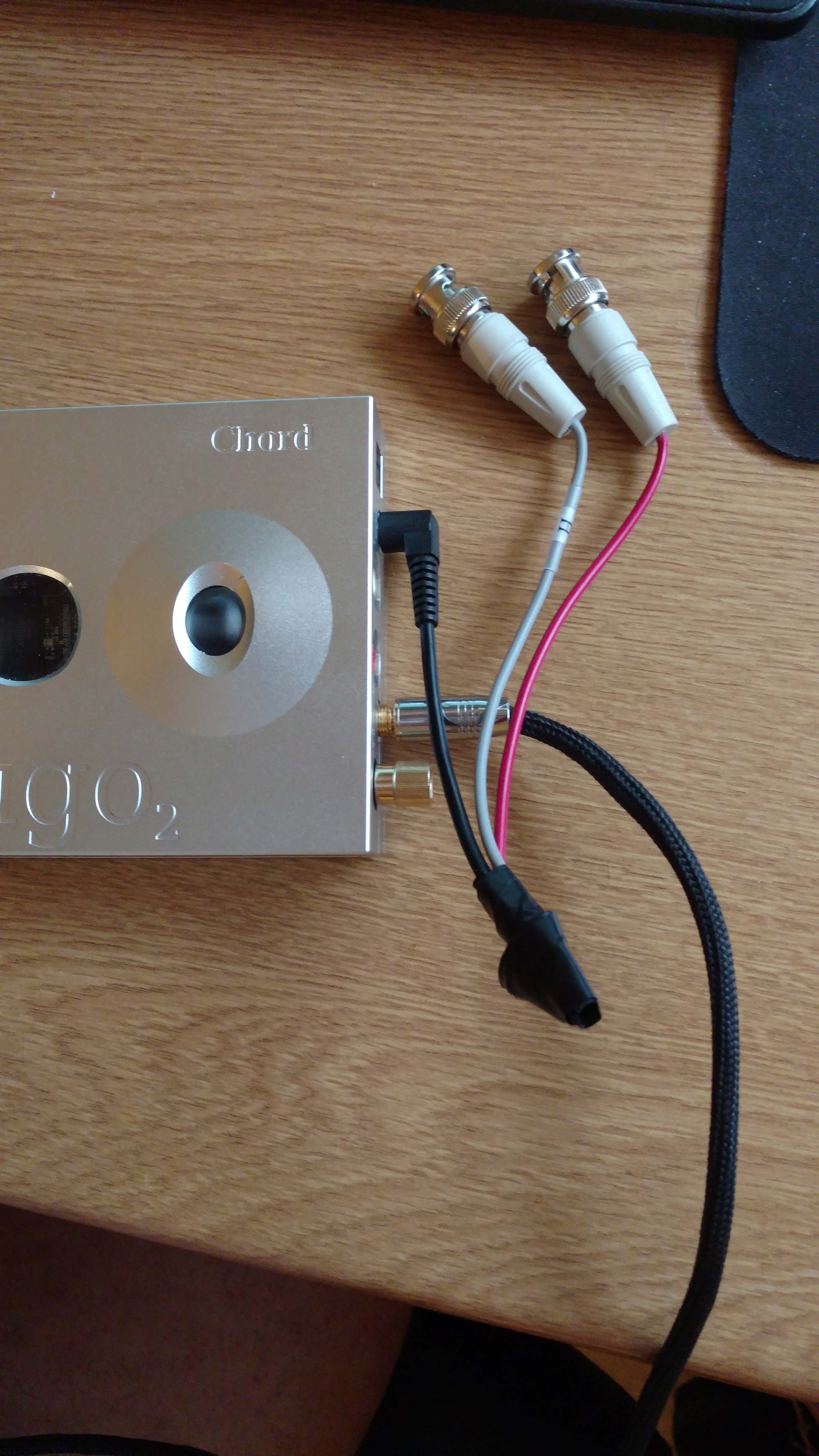

Hi @Rob Watts, I have tried using an Audioquest Pearl 3.5mm (1.5m) to RCA cable with RCA to BNC adapters to connect Hugo 2 with M Scaler.
Setting it to any rate works well but in Dual BNC mode the sampling rate flickers intermittently. What kind of cable can you recommend for optimal performance? Thanks!
I have never had issues with Hugo 2 - and I have used cheapo 1.5m cables, and a short bodge cable. It must be a screened cable. As other posters have suggested, try the adaptors and use the supplied BNC cables.

I have confirmed this by using the cheapest RCA cable bundled in most AV equipment and it worked flawlessly! Maybe there’s something going on inside the Audioquest cable that forks into Y RCA connectors.
I’ve ordered the adapters for the supplied BNC cables. Much thanks!
Many RCA to 3.5mm Jack cables are intended for headphone or audio use and may not be screened or suitable for reliable high frequency digital tranfer. So that is perhaps why it is better to use proper screened bnc to bnc cables and then just have the convertor at the H2 end. Your cheap RCA cable on the other hand is probably screened and why it works.
