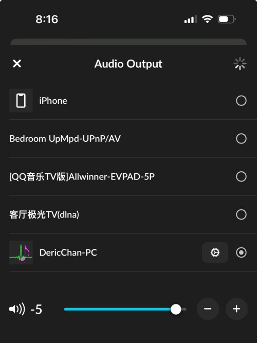

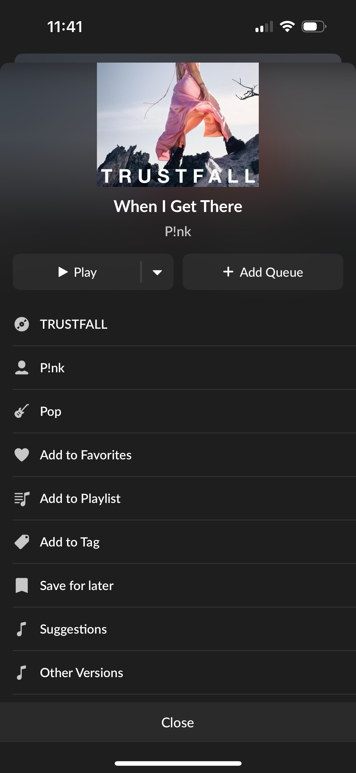

No Chris at AS forum had made a post to show the 5 simple steps to setup jplay iOS with hqp. It’s the best Xmas gift for me!!! You can now control pretty much all hqp functionality in the jplay iOS app and use the iPhone physical volume to control hqp digital volume… not to mention it sounds way better than roon/hqp (as much as many roon users who had not tried jplay iOS like to deny that) I have recommended to 3 roon lifetime subscribers and all three joined the jplay iOS lifetime subscription immediately…

Yes Marcin has been extremely patient about this integration. Other than some glitches at launch, it’s really been rock solid. What’s better, this is native support of hqplayer, with essentially jplay doing remote control of hqplayer’s api so it is different from upnp or Roon.
Jplay ios also supports tidal connect so you now have full native support for tidal with Hqplayer!!!
