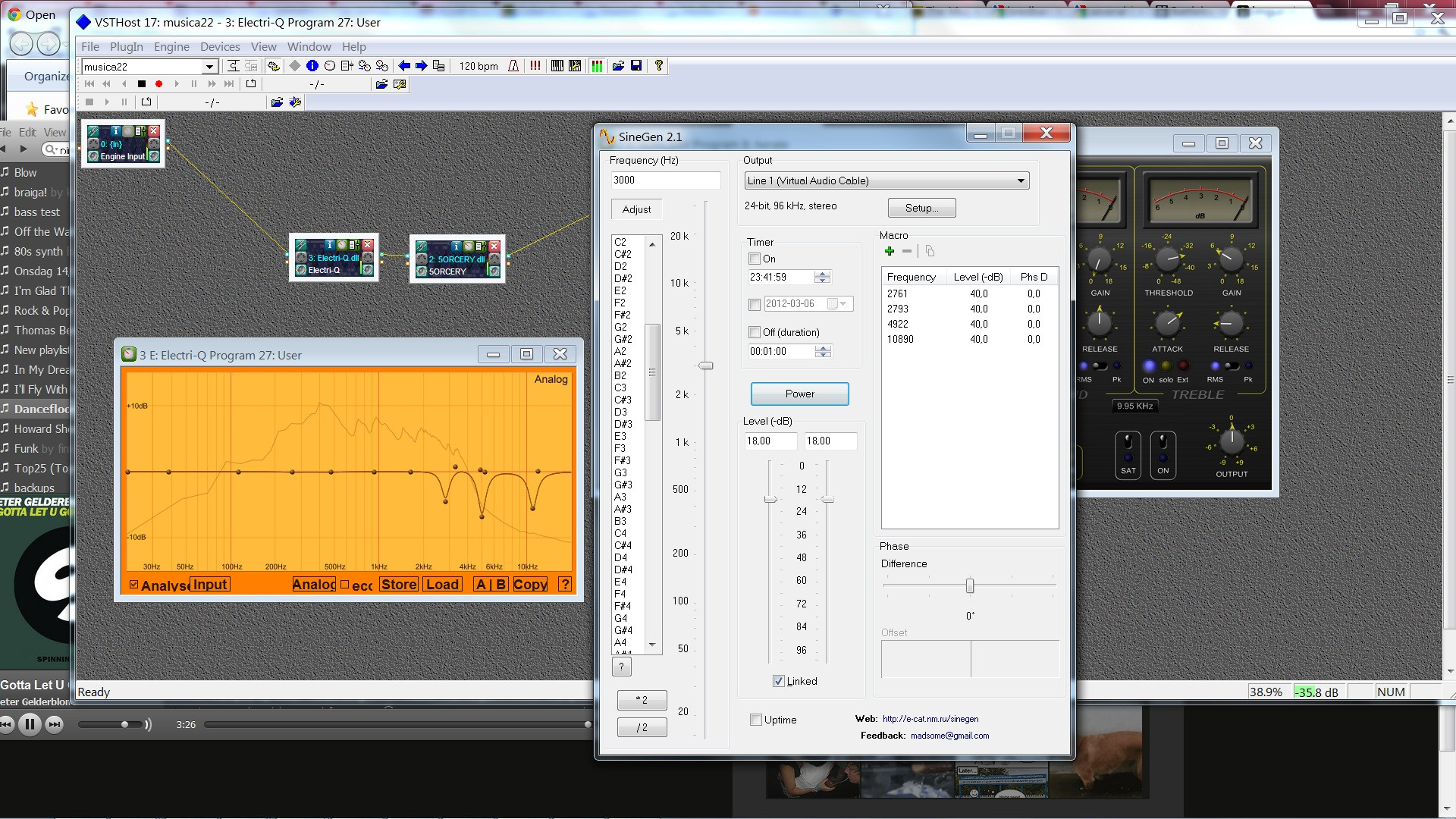

Awesome! Now that's what I'm talking about. Looks awfully familiar too...
My response.
Linkwitz's response. Notice that the HD414's had some problems in the 2.5kHz range, too. But look at the response he discovered for the high frequencies. I'm beginning to see a pattern here.

The Burn in Wave generator does not allow for the sweeping of the sine wave by hand, though, which is important for determining where the peak is and how loud it is relative to other frequencies.
does this work with crappy headphones? im still waiting for my HD650s to come in so right now im just using a crap pair of TDK's. i tried to listen out for peaks how do i tell which is a peak? it all sounds normal to me. sorry if im asking silly questions here.
It will work with any pair of headphones. I've even equalized cruddy pairs of grocery store headphones, just for kicks. To tell what is a peak and what isn't, just put the headphones on, load up the SineGen program (which I provided a link to), and press the "Power" button. Use the frequency slider to move the tone slowly up and down the frequency range. If there is a peak, you will perceive it as a sharp and sudden increase in volume on a particular group of frequencies.
