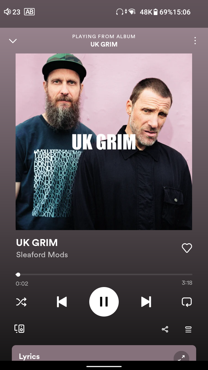

Issues with Bit Perfect streaming after Firmware Update.
Is anybody else having issues with BIT Perfect playback after 1.11_20230310-1937 upate with streaming apps? I had no issues what-so-ever with bitperfect playback (sans Roon Arc | Roon | Plexmedia) before updating but just noticed that Spotify, Qobuz, RadioGarden, etc.. are playing back 44.1 at 48K . Qobuz stream Hi Rez streams correctly, but CD Quality is no longer bit perfect. The only app working correct for me at the moment is Hiby Music Player.
Yes both tidal and Qobuz apps when playing 16/44.1, the R6iii displays 48K at the top of the screen.
I just plugged the R6iii into a USB DAC. The DAC is reporting 48kbps for 44.1 files. Other sample rates are working.

@Qualitas As a DAP playing through headphone jack I'm having issues as described. Hiby Music the only 44.1 stream for 44.1 playblack, using an external DAC I have the same issues (unless I use Roon ARC's "Enable USB Driver" in which case everything streams as expected to external DAC).
Using the R6 III as DAC from computer using Roon, System Audio, Qobuz, Spotify everything works fine.
Perhaps the strangest bit of all this though.... Spotify podcasts play as 44.1 while music plays as 48. I tried resetting to system default but that didn't change anything.
This is consistent to what I noticed. I think it just the spotify behaviour for this R6iii. I compared it with my Ibasso DX220, it show 44.1Khz for both podcast and regular song (tested with Pet Shop Boys)
