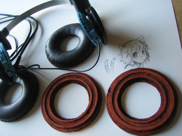

I'm tinkering on my PortaPros due to sniping some old "VIVANCO SR75" (old Audio Technica ATH-2 look-alike).
They had different drivers though... so the only fancy thing left was the headband so I thought of building some PortaPro drivers into them.
Change my mind though after I looked at the earpads, they were kinda ~nice and good as new.
Checked for mods on head-fi and discovered the Kramer-mod and the HD 414 pad mod.
I was recently doing some work on my longboard [ http://tinyurl.com/2wxe6w3 ] and thought I could apply the same technique on these cans... which involves etching wood to change its colour.
tl;dr
Porta Pros:
-Wooden cups
-different pads
-Kramer mod (which I still have to do)
Everything is still WIP,
I like to get the wood several tones darker
to harmonize better with all the black and the dark pads
... used a Dremel (pain in the ass), I need to buy a decent router for future projects.
Do you guys have some similar PortaPro mods to share or
some additional ideas to improve these phones?
                                                                                                                                                                                                                           also... don't mind Chen

@reiserFS haha, yes it's Cheeeeeeen :3 , but your nick is ridiculously good.
@mootookang ... I made 'em myself!?!
Just a plank of wood and a Dremel which could be used as (very bad and choppy) router.
After they were done I applied some etchant to change the original wooden color until I was pleased with the results.
Oh... I guess they're almost completed by now...
lost some of their portability though
look decent IMHO... but all those haters gonna hate while I commute to university...
the grill needs more sanding and a new varnish to shine again... just noticed while browsing through those pics
(Those ATH-2 Pads were a nice catch)
and a close up to see all the errors and faults of using the Dremel as a router.
