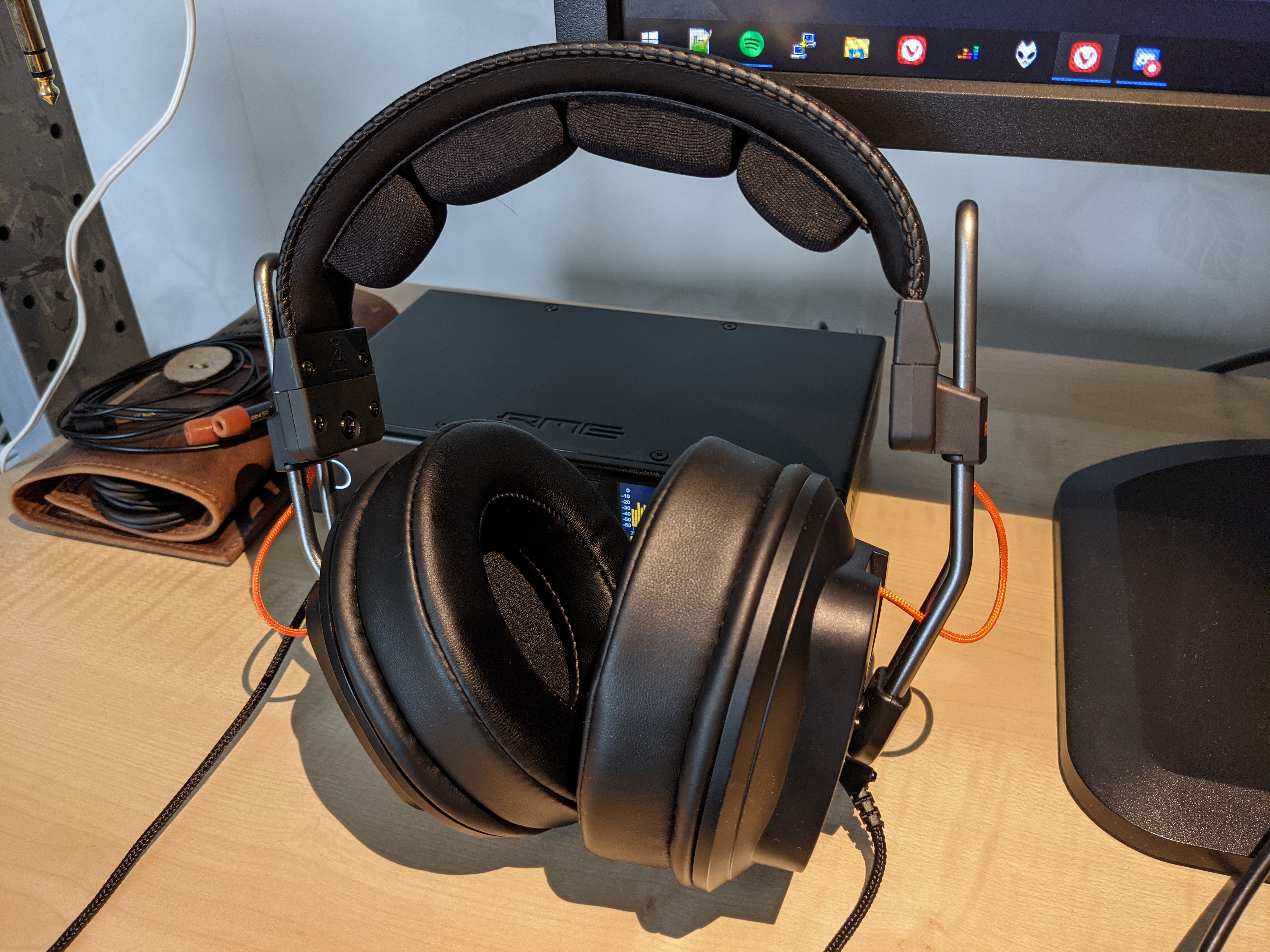

I recently got the T50rp and I have done the DVB#3 / Mayflower mod (they are the same right?) and I am very pleased with the results.
