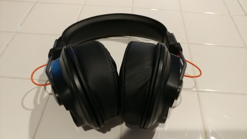

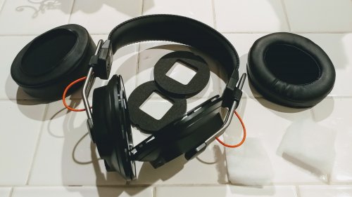

2018-12-26 11.59.53.jpg Windows 10/ USB >Topping D10>Coaxial> Audio-GD 11.28 > Fostex T20 MKiii
Been playing for the last 2 days and I think I found something that works for me, I've always had a thing for the MAd Dogs, So I replaced the Shure pads with the Brainwavz (angled) and these sound really good. I had taken the cotton out and lined the inside of the cups with thin Home Depot weather stripping. Sounded GREAT with the Shure pads...but I wanted that MAD DOG look. And I covered the back vents with black tape with a pin hole on top vent, suppose to act as a bass port..it does. The Brainwavz just sucked the life out of my sound :frowning2: mids and highs almost gone (without the cotton). BASS was monstrous though. So I added two layers of cotton back in there, taped to the back of the drivers...and DUDE..got my mids and highs back! The cool thing is tracks with not that much bass...sound like that, and tracks with bass....it has BASS. Luv it. Sounds better on my Lgv20> iFi Black LAbel> Fostex set up.. I never noticed Bob MArley physically moving back and forth from his mic during the recording of Natural Mystic.

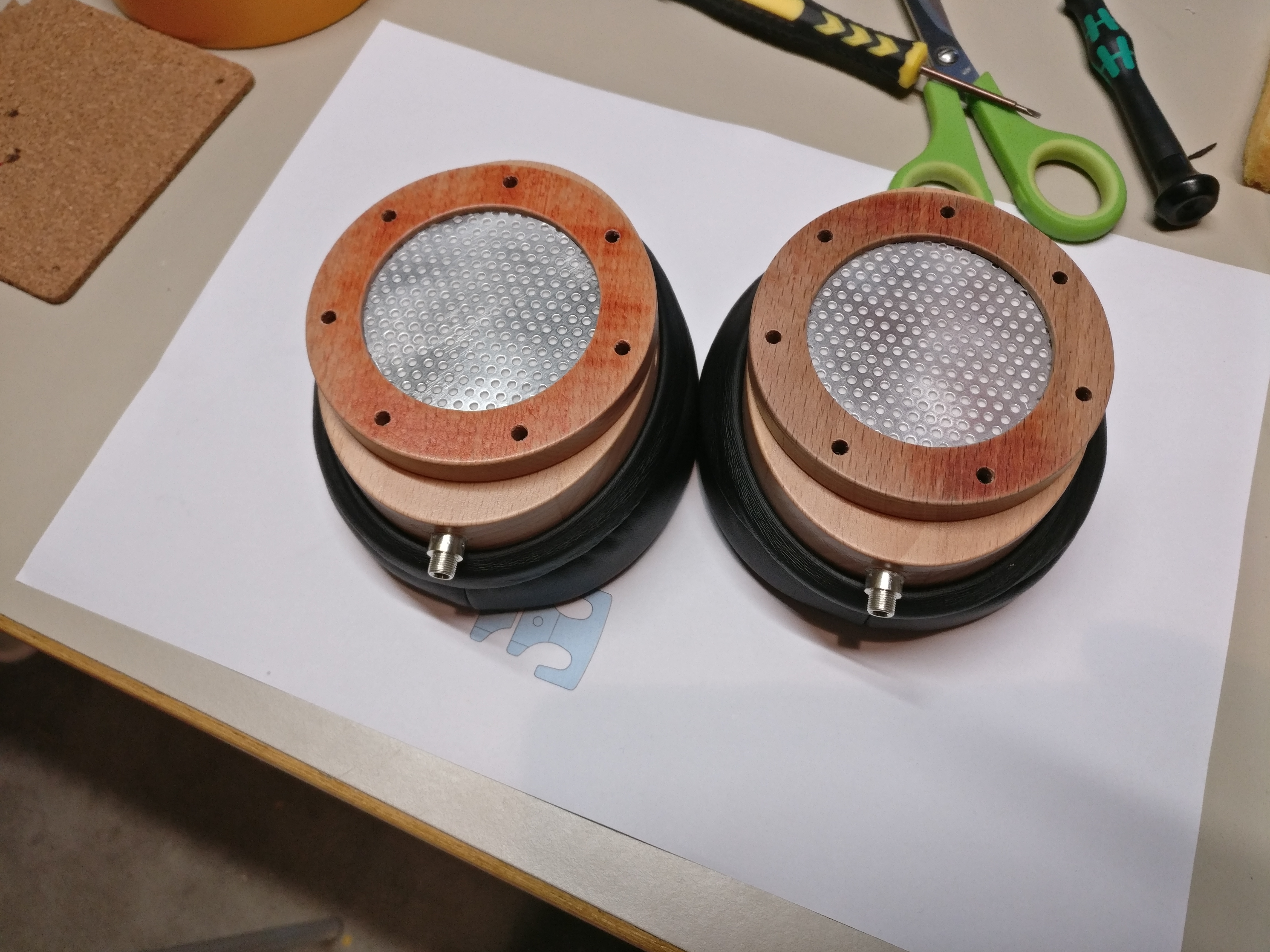

My brother ask me if I can make something with his moded fostex that doesn’t sound well. So I collect all ideas that I found on this forum that I was thinking will work and I made this semi open version. I try to make this mod more present sounding and more stage deep so that’s why is with angled pads. Unfortunately my preferred velour pads made this headphones bass less for my brother :) .
With other type of pads bass was loose and goes on mids making muddy sound skin pads also make disaster with highs. Maybe some hybrid pads with different tunning . Graph show comparison this mod with velour pads and two cotton rings behind to T-X0 raw and T-X0 equalized to Harman target using oratory1990 eq preset on my rig.
