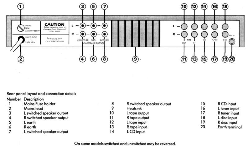

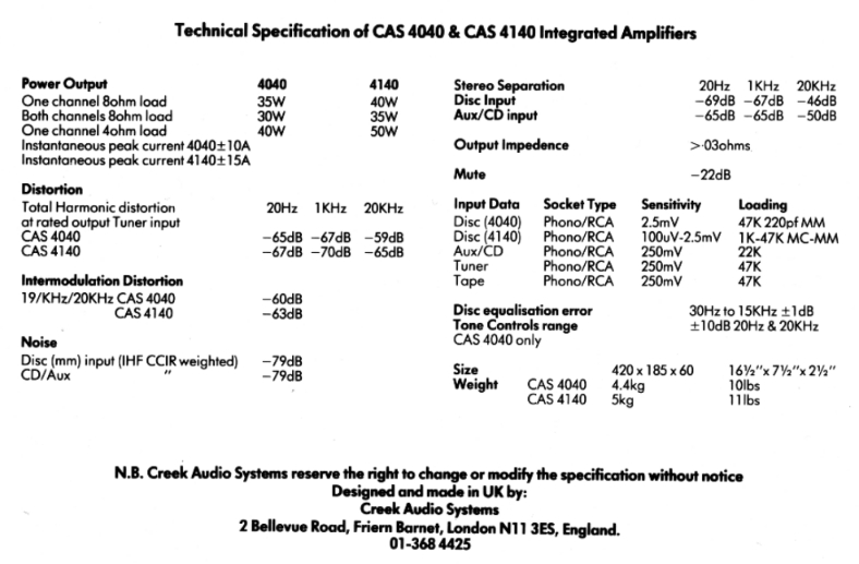

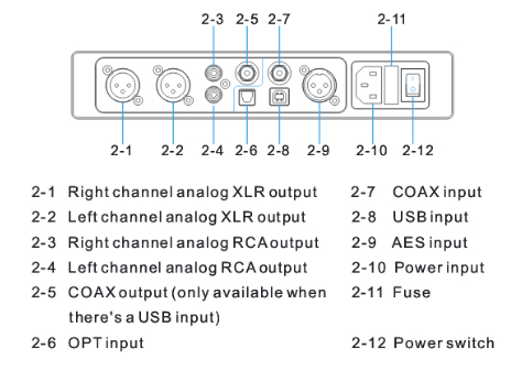

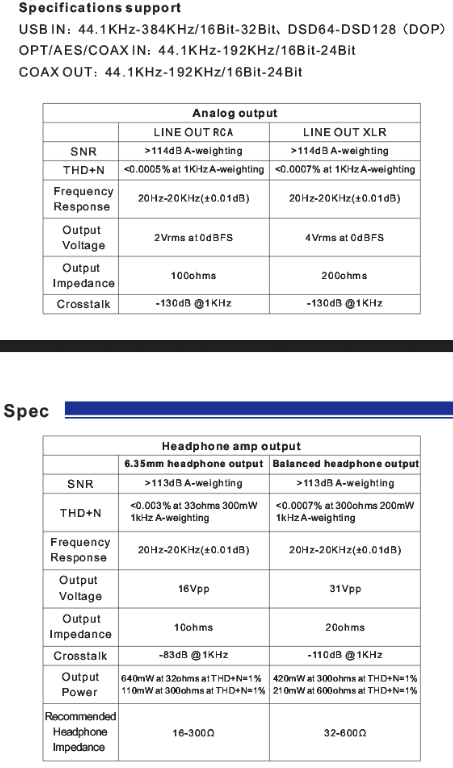

kintsaki can you give me advise how to try this POWER on my limited gears? Or more accuracy to say, how to get POWER without noise. Thank you.
Windows7 foobar2000(wasapi) > Topping DX7(coax in) > creek4140se(rca in)
