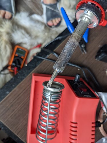

can someone recommend a more reliable solder station under 100 with a better temp control and smaller tips? I bought this low end Weller and its tip just broke up after I fix 3-4 of my cables( plus it successfully ruined 2 of my eidolic and plussound connectors today, I'm gonna rage quit this piece of crap...)
Not sure how much it is over there but the Hakko FX-888D is very good, as are their tips. But Weller is good. Are you keeping your tip cleaned all the time and “wet” (ie when you aren’t using it are you making sure it has some solder in the end to stop it drying out and becoming brittle?)

Well I forgot to keep it wet all times, but I do clean it often during my soldering. This was wlc100, I've already ordered replacement tips, hope it would work for me. I really miss old days when I have higher end Weller in my school lab... These Weller are kinda around 300 and they are simply magical.Not sure how much it is over there but the Hakko FX-888D is very good, as are their tips. But Weller is good. Are you keeping your tip cleaned all the time and “wet” (ie when you aren’t using it are you making sure it has some solder in the end to stop it drying out and becoming brittle?)
