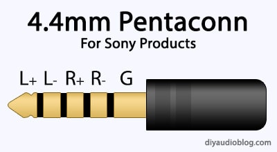

The amp side would be either a 4xlr (desktop amp) or a Pentaconn 4.4mm balanced plug if i decide to use it for my portable dap, a iBasso DX220 with Amp8 which has this type of output.
I havn't found the pinout for the Pentaconn 4.4mm balanced plug yet... does somebody have a hint?
Is this what you’re after? The soldering points on the inside correspond with the outer rings, but check with a multi-meter before connecting. Oh and you don’t use the ground connection.
