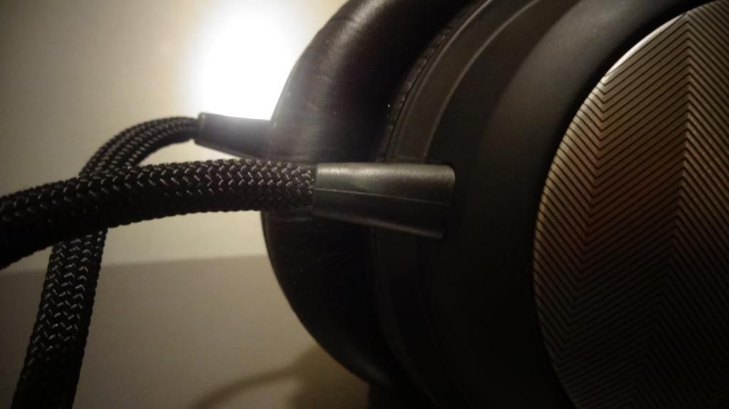

I recabled a pair of T5p headphones today. Man those drivers are heavy!
I ended up having to use some (whatever these things are called) from some pairs of DTxx0 headphones because the hole diameter was bigger than the ones that are on the T5p. Beyer really skimped out on cable quality on these headphones. Thin wires and Rean connectors? Come on Beyer!
