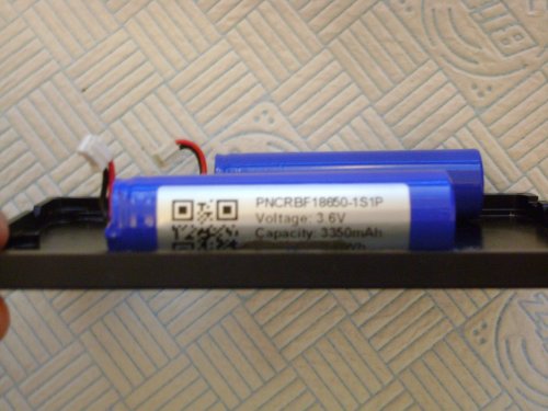

Those batteries are ligitmate. I opened my Hugo 2 and my batteries are exactly the same. My Hugo 2 was bought new from Audio-T in the UK.
I have taken a couple of pictures of inside my Hugo 2. Long story, had to open it anyway, so today seemed like a good idea to do it now. (What with all the battery talk.)
I could not get a complete picture of the battery label, but there is enough to show which battery. I could not get a complete picture of the battery label, because the batteries are stuck to the case. If you look under the word 'capacity', on one of my pictures, you can see the adhesive. I rolled the battery to see the label, but didn't want to move it further. I wanted the battery to still be stuck and it is, when I rolled it back into place. If I had pulled it off further, I could not be sure the battery would have re-stuck.
Anyway my pictures:
In this last picture you can see enough of the label. It can be identified as the same in the picture I got from the internet today. The one at the top of this post. That picture has the complete label.
My pictures confirm the 3350mAh battery. My battery life was 7.75 hours when new. Also note the connectors on them.
Anyway my pictures:
Looks like good news for new Hugo 2 buyers but a lottery for used buyers.
Anyway my pictures:
Cool Any place in the USA to source these batteries? And looks like no soldering required?

On the list there is the MLG9015, which @technobear listed from this website. https://www.enix-energies.co.uk/lithium-ion/ … However that is a 9.6 Wh battery. The batteries in my Hugo 2 are 12.06Wh batteries, which we discussed.
The batteries in my Hugo 2 are not labelled as Enix Energies. In fact they are not even branded. (See pics above.) I suppose someone could strip the plastic coating off when their batteries expire. Thus to see if there is a brand name and battery model underneath.
  • However with Li-ion battieries you have to get the right type. There are quick discharge and slow discharge types. Hence the many stats on the batteries, like nominal discharge rate.
  • Like on Amazon, there are batteries of this size which have three times the storage capacity. Like one at 9900mAh. https://www.amazon.co.uk/9900mah-Ba...=18650+li-ion+battery&qid=1596147373&sr=8-269 (Compared to Hugo 2 batteries at 3350mAh.) High capacity batteries may be for slow discharge though, like a doorbell. I don't know, so anyone looking would have to make sure.
On the list of Enix Energies batteries, there are two 3400mAh. Although 18650 is a battery size, one is just over 650 long. There is not much room in the Hugo 2 to adopt battery size variation, at all. Again that would need to be checked. I am not re-opening my H2 just to measure that until I need to. I am not looking for replacement batteries. I just got looking, since folk were asking. Then I needed to open my H2 tonight, so photo-ed the batteries.
It does seem that going through Chord would be most straight forward process. However if by unwrapping a battery, if all the specs were there, that would be a helpful.
