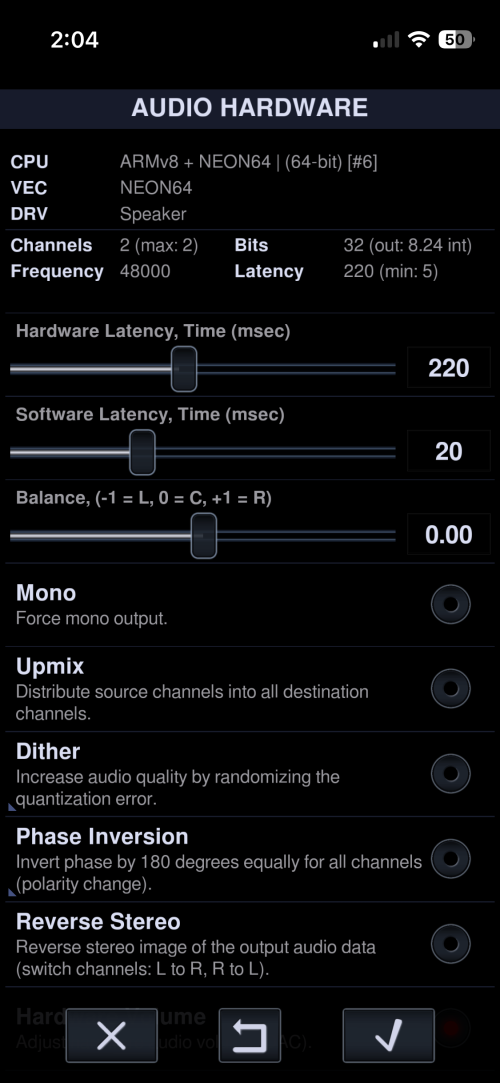

I always using "wifi mode" for playing both sd card and streaming (tidal), apps using: Rigelian for sd card; and MConnectHD for playing streaming. Few days ago I saw a post here talking about using difference apps for access sd card would have different sound, and his best recommendation is "Neutron", so I tried it, but the drop out is very serious, so I asked what configuration should be made, and replied "hotspot mode" he's been using; so I swap to hotspot mode, really got Neutron work, and not just work, it is amazingly best sound ever heard in 2go + Hugo2!! Today I tried playing some dsd files with Neutron, it just have a very loud "white noise" in the background. So I check the Neutron, it should support dsd file, so I tried to change output to ipad mini, and sound is normal again! No white noise in the background; and I tried on/off "perfect bit", still cannot play normally of dsd through 2go in Neutron apps......that's the story today
Hi @Skeith can you play dsd file through Neutron to Hugo2?

I've read posts before saying whatever what MPD apps for reading SD card file should be the same sound, but I can quite sure to tell you all that Neutron really have obvious better sound than Rigelian at least. I tried to get some tracks that I mostly not quite satisfied playing in 2go before, now I switch to Hotspot mode and using Neutron, obvious more dynamic sound, better instrument separation, overall more musical performance!! Highly recommend for all 2go users, just 2 things: only work in Hotspot mode; having big white noise when playing dsd file. Hope to solve the dsd playback in Neutron would be a great bonus for me.
