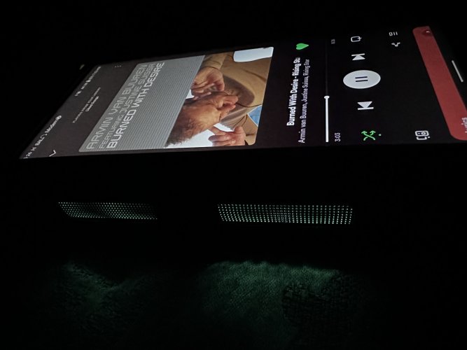

Argh, I can look & listen to this all day. :ksc75smile:
This DAP has sort of revitalized the hobby for me and my overall enjoyment of spending hours listening to music. I went through a phase of only having short 20-30 minute sessions while I was making my early morning breakfast or perhaps during dinner. The N30 makes me want to spend hours listening to music rather than being glued to the TV when I have free time at home watching whatever I can to pass the time. I have missed this feeling. :beerchug:

Right there with you!
I was doing the same thing. Listening for random short periods of time and then just streaming shows…but now every single chance I get to listen, even if it’s for 10min I’m pushing play on the N30LE. This DAP’s SQ will push the hobby forward. I don’t know how anyone will top this sound….maybe LP7 when it’s released in 2099! 🤭

My feelings exactly!
Every occasion I have I pick the N30, push play and time disappears :ksc75smile:
As I said, it's almost like a drug :beyersmile:
