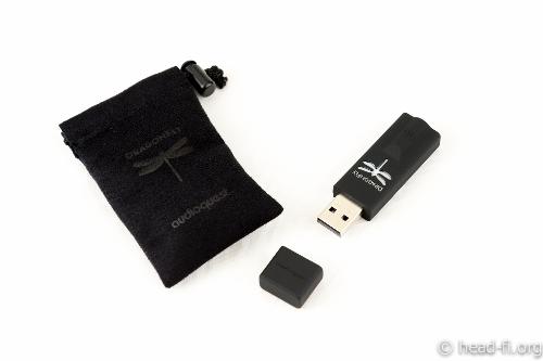

(above) The AudioQuest Dragonfly USB DAC/amp, uncapped, with its included drawstring carry pouch.

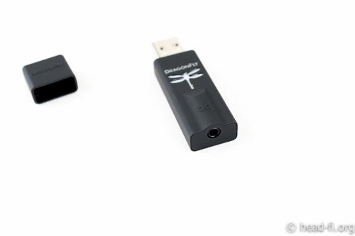

Again, the Dragonfly looks like a fancy USB thumb drive (in a heavier duty metal chassis), but with a mini-jack (3.5mm) output on its rear end. If you plug a mini-plug-terminated interconnect cable into that jack, then you've got a DAC with a 2-volt lineout that you can plug into your favorite headphone amp, preamp, power amp, integrated amp, or receiver. If you plug a headphone directly into that jack, then you've got a surprisingly good (and outlandishly portable) DAC/amp combo.

(above) The AudioQuest Dragonfly's line-out / headphone out (3.5mm mini jack) up-close.
