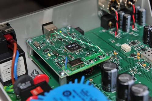

Feb 19, 2024 at 10:17 PM Post #1,414 of 1,416
Still in work today.:beyersmile:
