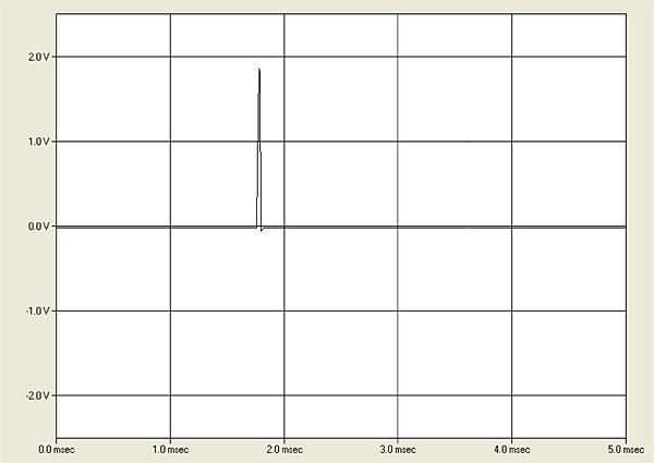

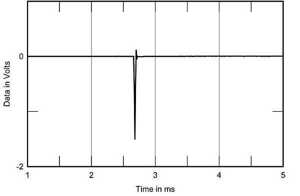

For all others. You may not understand these technical issues. One things is beyond dispute. The Audio Precision SYS2722 is able to capture 1kHz NOS square wave without visible ringing. These examples are captured by JA using the same analyzer:
1. Audio Note CD-4.1x CD player. This one I know is very well sounding player, true NOS design.
2. Audio Note CDT One/II CD transport & DAC 2.1x
3. Peachtree iDac D/A converter. This is not ladder type, but Delta-Sigma where (I think) designers managed to bypass the internal digital filters (ESS 9016).
