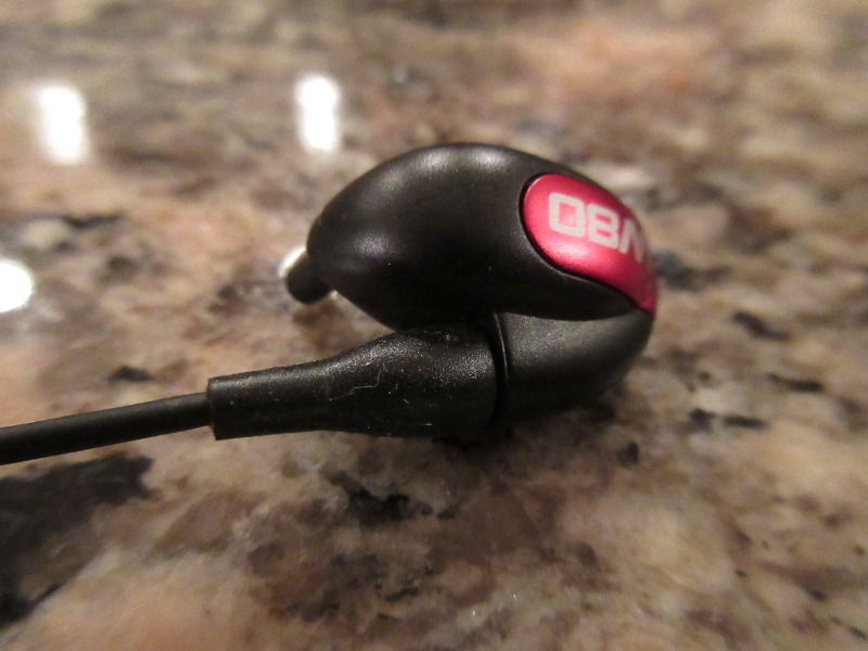

Need some advise from people who own W80. I purchased a used unit and need some clarifications
a) The connection to ear piece - well it rotate freely like if it is loose but it is not loose or come off. In Shure SE846 the ear pieces can be turned/rotate to facilitate to achieve proper insertion to ear but still it does not rotate freely around the cable. Is this normal or part of design of W80?
b) ALO cable seems to be having some kind of damage in the stereo connector end- that is with slightest move I get distortion or only one channel working. My question is is there a a sound quality difference between ALO cable and other cable provided

a) Are you talking about Westone cable w/remote or the ALO Ref8 cable? They both will rotate, though Westone (black) cable has their new MMCX audio connector which is tighter, while ALO uses universal mmcx connector (thus a little gap) and will be not as tight.
b) ALO cable 3.5mm connector, does it look worn out or different from this?
It should fit tight. Could be something wrong with a cable you got from a seller. Btw, you mentioned you get intermittent problem with one of the earpieces. Is it always one specific side? If you switch mmcx connectors between Left/Right earpieces, does the problem stays with a connector or follows either L/R earpieces? It could be not necessary a problem with 3.5mm plug, but rather one of the mmcx connectors.
a) Are you talking about Westone cable w/remote or the ALO Ref8 cable?- ALO cable and mine look like your pphoto 2

a) Are you talking about Westone cable w/remote or the ALO Ref8 cable? They both will rotate, though Westone (black) cable has their new MMCX audio connector which is tighter, while ALO uses universal mmcx connector (thus a little gap) and will be not as tight.- It looks like your second photo. It rotate someone freely but does not come off
b) ALO cable 3.5mm connector, does it look worn out or different from this? Looks like the same. If I hold the cable and the 3.5mm connector firmly with no movements allowed it work without any distortions or channel issue so the problem with the cable not the IEM itself

In Westone cables the connector housing mold extends a little further, giving the connector an appearance of shorter profile. That's why Westone cables don't work with other mmcx connector iems (like 846 or UE900). But any universal mmcx connector cable will work with Westone iems, and ALO Ref8 has universal connector. The rotation is normal.
ALO Ref8 is a premium cable, 8 separate conductors (thus Ref8 name) with 4 pure copper and 4 silver-plated copper vs Westone typical oxygen free copper cables. I personally hear the difference and improvement, but then I'm a very strong cable believer :wink:
