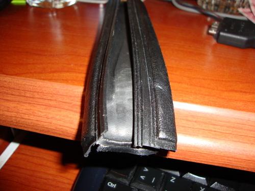

I've changed the headband for the same reason. I bought the headphones in 2007, after 1.5 years I realized that using the headphones when one's hairs are wet harms the headband. It rots easily even if one only does that mistake. As for your last question, I totally removed the old headband by separating it from above. The old headband should be removed completely as the Pro headband will not merge before doing it.
The old one:
Jun 6, 2010 at 5:36 PM Post #11 of 17
Great pics.
There's no doubt that it  deteriorated badly.  Was it sticky?
Did you ask Beyer if they would replace it?  That shouldn't happen.
It's hard to believe that water from wet hair can deteriorate plastic.......  were you using gel?
Was it in the sun?  UV can deteriorate plastic.
My original '03 headband is absolutely fine.  I wonder how many other bands have deteriorated like this?
