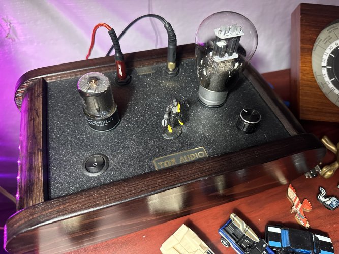

I see...on the photos/review video there is only a 4 pin xlr output to see. I will ask! But the xlr>SE cable that comes with the amp suggests also, that the XLR output is in fact an SE. Otherwise I can not imagine how this cable does not blow up the amp.
Must be a typo error on the website. I've checked, all models have the same output connector, but the pics and video reviews on the net show differently
I got an answer for my question:
“XLR>6/3 converter cable - The cable simply contains two connected ground pins, which are separate when balanced.”
Not sure where is a ground to begin with, but I will leave it at that now. If I have the cable/equipment I will do some basic measuring.

I did research a bit more. The thing is, that a transformer coupled balanced amplifier indeed has no problem with the afformentioned xlr>6/3 cable. If the transformstor is not coupled to earth and it is symmetrical winded, than connecting such a cable would form a center tap and thus a ground connection.
However! The same cable would blow up my Pathos Inpol Ear amplifier. In matter of fact, all semiconductor based amplifier. (Or trigger some protection circuit).
