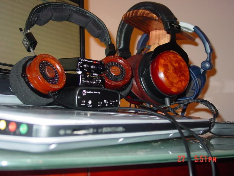

I listened from my Sony Vaio laptop using JRiver’s Media Jukebox 12. Most of my comparing was done with RS1’s, but I did listen with the rest of the cans I own enough to see that neither amp had any trouble driving any of the headphones I own. I was having trouble with my IEM’s so those unfortunately did not get much attention. I spent quite a bit of time comparing the DAC section of both the Predator and the Pico to my MicroDAC (with an upgraded opa 2134 chip) and to my Stello DA100.

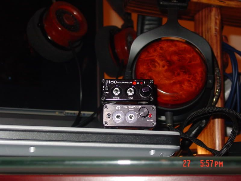

Naming a winner between these two will come down to personal choice and headphone compatibility. Neither is heads above the other, but they do sound very different. I was a little worried before getting both amps that I wouldn’t be able to hear a difference & would have nothing to write
Luckily that wasn’t the case. In fact I was able to name the amp 10/12 times while my hubby changed them behind my back!
The Predator was more aggressive and punchier sounding. There is plenty of air and space between the instruments. I did not have a sense of congestion with it at all. The highs were a bit too bright for my tastes even with darker sounding cans like the DB’s. The Pico has a bit darker and more full or rich sound. The soundstage sounded a little wider to me, but this might have been my ears reacting to the more aggressive and forward sound of the Predator. The bass is just a little more weighty and extended with the Pico than with the Predator. The high end is not quite as bright. If I had to choose only one of them I would probably go with the Pico. I prefer the smoother, richer sound even at the expense of the more aggressive punchier sound of the Predator.

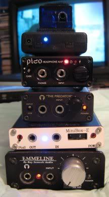

The discussion of the amps is coming soon. Here are some photos comparing the Predator and the Pico to other amps. From left to right: Xin SuperMini IV, Predator, Pico, SR-71, Mini-Box E, Xin SuperMicro IV, and the stack is self-explanatory.
