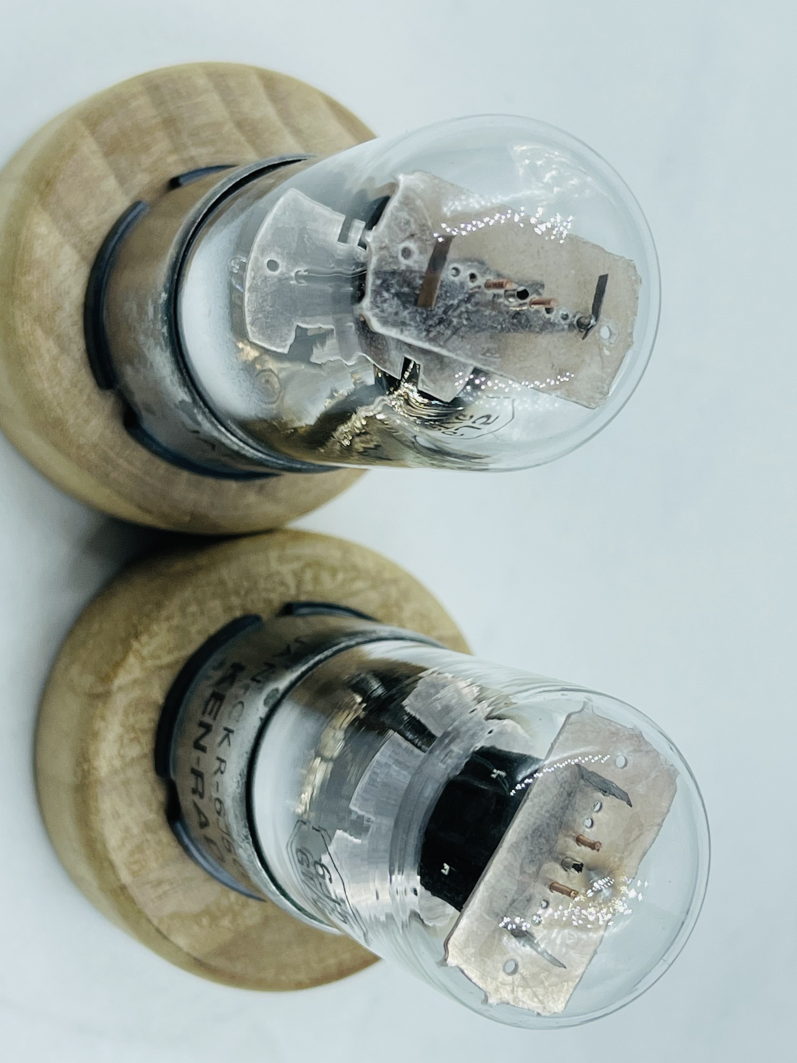

How about these?
All printed 'Mullard 6J5GT British Made'
leftside
And to finish the pictures this evening with some more tube porn. A few US tubes tomorrow.

This one's quite interesting. I think the Mullard tubes have those extra support rods quite consistently and they're absent here. We have a notably different bottom mica which looks like it was design for those extra support straps you often see on the RCA/GE models, but the supports themselves are not here. The grid posts are copper too, Mullard tubes typically use steel here.I believe these are also Mullard? Foil getter.
It actually looks a lot like a Ken-Rad to my eyes, but I would not go so far as to suggest it is one because there is no evidence that Ken-Rad tubes were ever exported and re-branded during the time Ken-Rad was actually making these.

Boom! You nailed it. I also took photos of my US metal base tubes and indeed this is the same construction as KenRad. Will post up the photos tomorrow.This one's quite interesting. I think the Mullard tubes have those extra support rods quite consistently and they're absent here. We have a notably different bottom mica which looks like it was design for those extra support straps you often see on the RCA/GE models, but the supports themselves are not here. The grid posts are copper too, Mullard tubes typically use steel here.

For me. This would be.How about these?All printed 'Mullard 6J5GT British Made'
Mullard. Brimar. Sylvania.

I can see that....love the extra support rods on all of those Mullards....sexy!
My 'Brimar' 6J5GT/G that I have posted about previously look to my uneducated eye the same as these. They seem to have some kind of bottom getter on the same side as the foil. This can also be seen in one of the links to that bay that I posted previously. They are marked with white lettering and numbers inside on the pinched glass structure. The one I am looking at now says A43. (I'm sorry, I haven't found my Kodak Instamatic yet)I believe these are also Mullard? Foil getter.
The orange lettering on the glass rubs easily off. It says Brimar BVA. To the left of this you find 10 and below 10 you find 1. To the left of 1 is a 4. It's not 41. Some letters above Brimar has almost totally rubbed of. The metal base is corroded. The remnants of the text on it is also orange.
A photo says more than a thousand words...

Same as KenRad. KenRad making tubes for Brimar....This one's quite interesting. I think the Mullard tubes have those extra support rods quite consistently and they're absent here. We have a notably different bottom mica which looks like it was design for those extra support straps you often see on the RCA/GE models, but the supports themselves are not here. The grid posts are copper too, Mullard tubes typically use steel here.

I wasn't sure about the tube on the far right. So here we have another US manufacturer, in this case Sylvania making a tube for Mullard... And here's a Sylvania tube marked Sylvania (same construction as the Sylvania/"Mullard" from above).For me. This would be.

If your "Brimars" are identical to these, then they are also actually KenRad manufactured. Good tubes btw.My 'Brimar' 6J5GT/G that I have posted about previously look to my uneducated eye the same as these. They seem to have some kind of bottom getter on the same side as the foil. This can also be seen in one of the links to that bay that I posted previously. They are marked with white lettering and numbers inside on the pinched glass structure. The one I am looking at now says A43. (I'm sorry, I haven't found my Kodak Instamatic yet)
They look the same or very similar. Do these have a sheet metal bottom getter with a wart on it? Any lettering on the pinched glass innards?If your "Brimars" are identical to these, then they are also actually KenRad manufactured. Good tubes btw.
Now the question is; who made these for Ken-Rad? (I seem to remember that one of the auctions I linked to previously was a Ken-Rad and the other a Brimar).

Yes - foil getter. You can just about make it out in the pics. I'll check for any lettering, but can't remember seeing any.They look the same or very similar. Do these have a sheet metal bottom getter with a wart on it?
