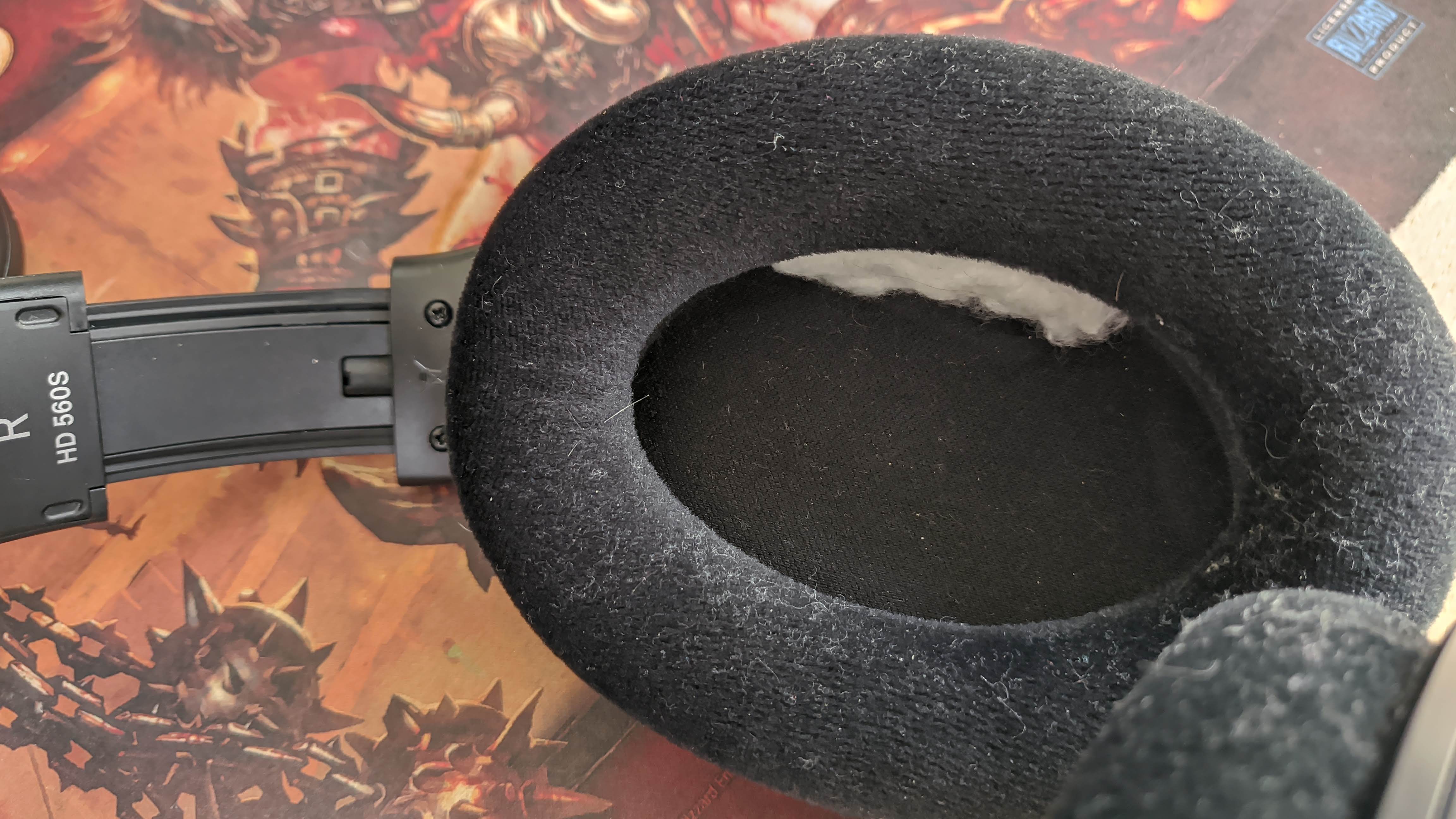

I think I've found the solution to my comfort problems. Since I've had these headphones, the one thing I've struggled with is the little notch that sticks out inside the cups. I've tried a number of things, like stuffing cotton wool under the pads, different pads, but nothing ever truly solved the problem.
On a whim I tried picking a small section of cotton wool and just trying to cover the notch, to my surprise this works fantastically, the odd feeling when my ear presses against the notch is completely gone now, and I'm now very happy with the comfort.
The only thing now to do is to try and find something black to take it's place, as it's not particularly aesthetically pleasing.
[edit] I should add, the aim is not to stuff it under the earpads, but to cover as much of the notch as possible, but you don't even have to cover the edge, just the outside of the notch that your ear would touch if pressed directly against the ear.

Interested in the 560s again but worried about the triangle notch inside the ear cups. Question to people with big ears: do they become less bothersome overtime?
The triangular thing inside the earcups doesn't bother me. In fact, I forgot it was there until I read your post.
Apr 11, 2021 at 2:45 AM Post #2,218 of 2,621
It bothered me when I tried the 560s at the store. I guess I have big ears. That's why I want to know if this will get better over time.
For me it's been a problem, I find you have to ensure you position the headphones towards the back of your head. I did find a compromise though, check my post #2210, this worked for me, just keeps the notch from feeling harsh on my ears
Apr 11, 2021 at 2:48 AM Post #2,219 of 2,621
Yeah i read your post. Have you found a more elegant solution? I don't like the look of white cotton inside the ear cups either.
