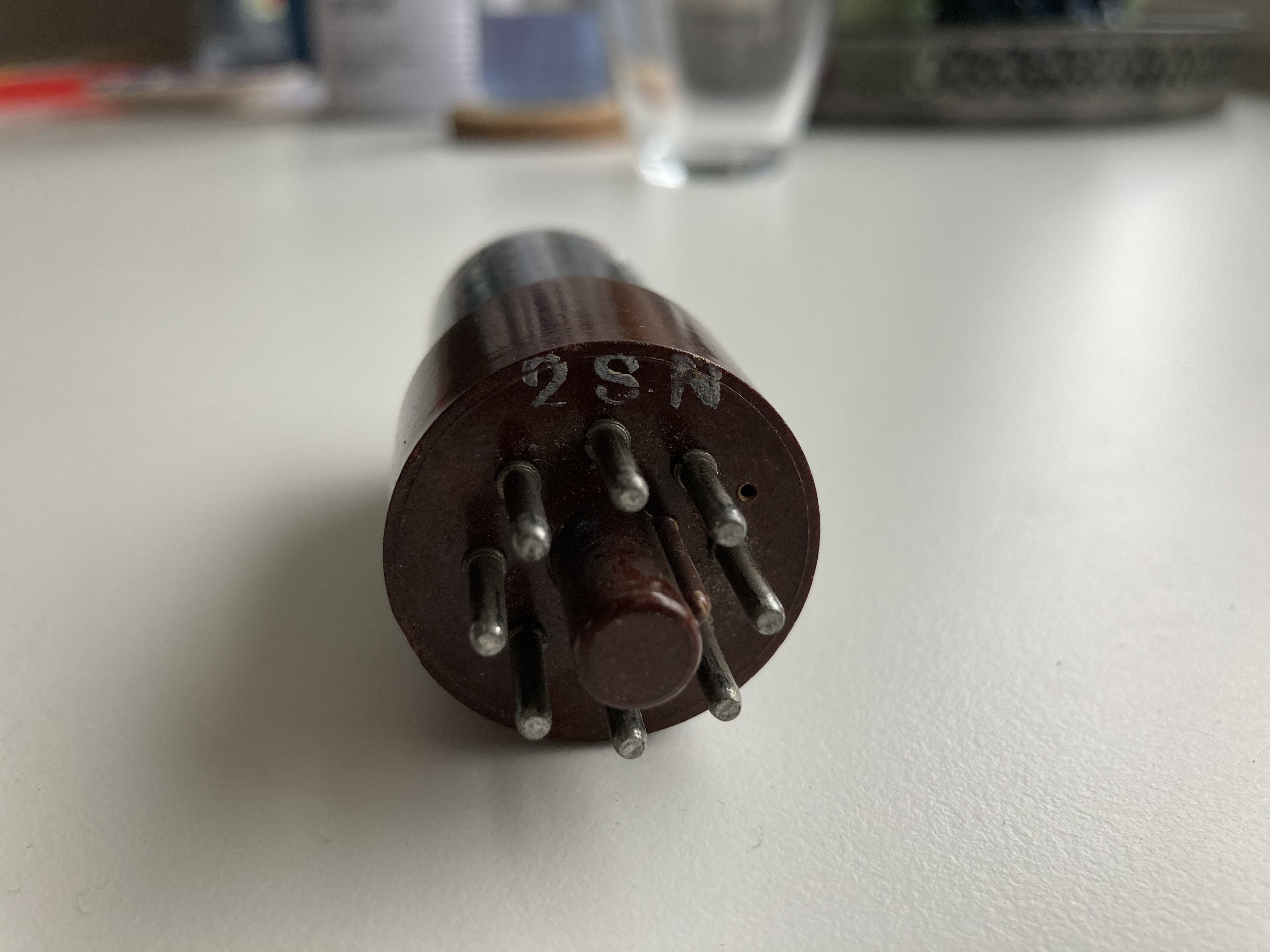

Last weekend I rebuild the previously pictured self build 1626 Darling amplifier (also found on this forum, sold as Amps and Sound Kenzie) that's doing speaker duty in my study.
I rewired the driver section from 12SL7 to 12SN7 (Led bias, CCS@4ma) and started looking around my collection for 12SN7's when this tube was found in one of the boxes.
Yesterday (see pictures) the Darling amp had it's small blue Edcor on there, starting today it's singing with massive AE transformers (build for 300b kind of power).
I scratched my head a little as I had never seen a tube like this.
CV925 made in Tottenham UK, with broad arrow and a Tottenham top mica plate.
Here's a CV1932 Mullard made in Tottenham (6J5 for US) mica for comparison, notice the similarities?
So that's half a SN7, and we agree you can buy actual 6J5's made by Mullard.
It also wears the Philips tube code 0K1 (12SN7) J5F (Tottenham June 1955?).
So is it SN7? An unexpected coincidence or confirmation of this came at it's bottom (as with other Philips / Mullard tubes).
The writing here says 2SN or 28N, but i like to read 2SN as a way of telling a 12SN7.
So, is it a true SN7 and not a 33 or 32 equivalent like Mullard is known for?
Here's the test results and traced curvers of the actual tube -> It's a true 12SN7!
12SN7 Mullard CV925:T ^LJ 0K1 J5F.png12SN7 Mullard CV925:T ^LJ 0K1 J5F Tracer.png
@cddc You were really close! Good thinking!
As far as i know Philips Heerlen/Eindhoven factories never did a 6SN7. I have a bunch wearing all sorts of Philips type labels, with RCA type build.
And the type B65 in my collection is staggered plates (can't get it in a picture because of the black coating).
