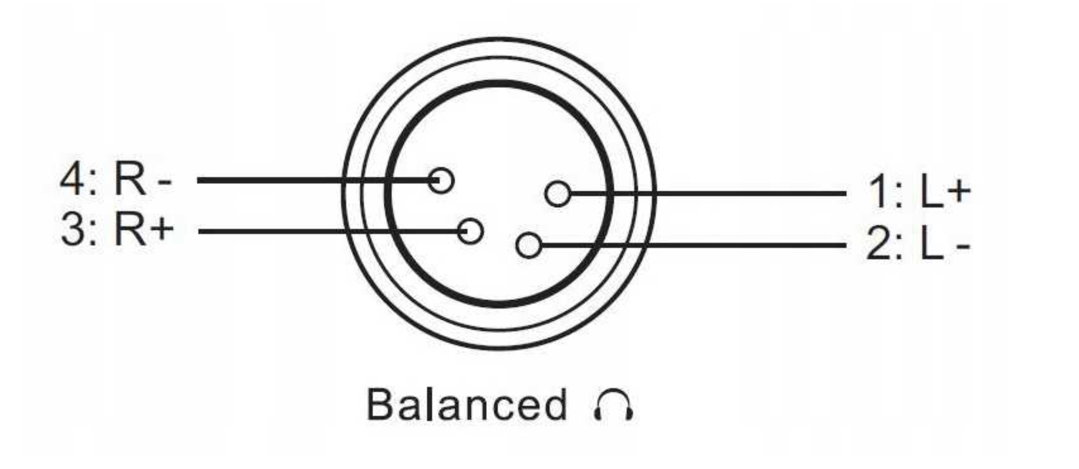

What amazes me is the sparse information about running headphones this way. To use dual mono amps I will need to make a "balanced" headphone cable as it would not be a good idea to have the speaker ground terminals of 2 different chassis tied togethere. Hope this information answers some questions for folks. I also would like to caution folks to not try this unless you understand exactly what you are doing, and have confirmed that the grounds of your left and right output lugs on the amp are connected. Further, no bridged amps, no dual mono amps. Dual mono amps should not be used unless the headpone wiring is balanced (different grounds on L and R channels, NO headpone plugs!)
