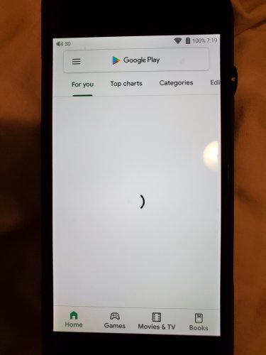

The 2.74 update broke my playstore. Shall I remove + reinstall it? It was working fine with the shipping 2.62 firmware. Thanks
Did you perform a factory reset after applying the firmware update. You can only get away with no factory reset if updating from 2.73 to 2.74

No I did not. Uninstalling/reinstalling solved my playstore issue. They should write down that factory reset is necessary...

You can bookmark this page, where we explain how to install Google Play store, after which you can easily install anything through store.
http://en.shanling.com/article-M6Setup.html
We have it marked in red on sites announcing firmware updates, such as here: http://en.shanling.com/article-M6V2-74.html
I also added it now to the Setting up page.

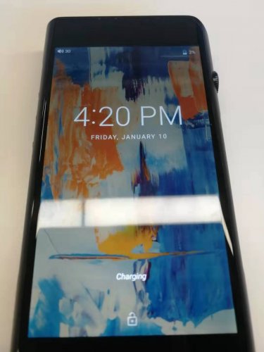

A few issues I'm seeing on M6 with FW 2.74 are...
1. On the lockscreen I have time in 24-hour format even though I set time to be in 12-hour format
2. On the lockscreen the date is displayed as 1 day ahead and the year is in Chinese characters. For instance it's 1/9 (January 9) today, however the lockscreen date is 1/10 (January 10) with Chinese characters interspersed.

#1, and #2 on my intl device, running 2.7.4 exhibits the same quirk.
