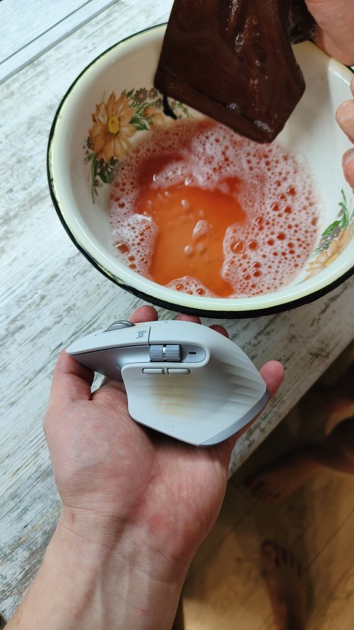

@Shanling there are problems with your case. he is of course very nice, but he handed the paint to the dac and from the dac to my hands. as a result, my Logitech mx 3s mouse suffered. it's ruined... this is not wiped off by anything. guys, keep in mind the case paints everything it comes into contact with!!!
You mean the velvety pouch that comes with the H7? I use it with my H7 and even with M9 and haven't seen any problems with pain coming out of it. But I didn't tried to soak it yet.
