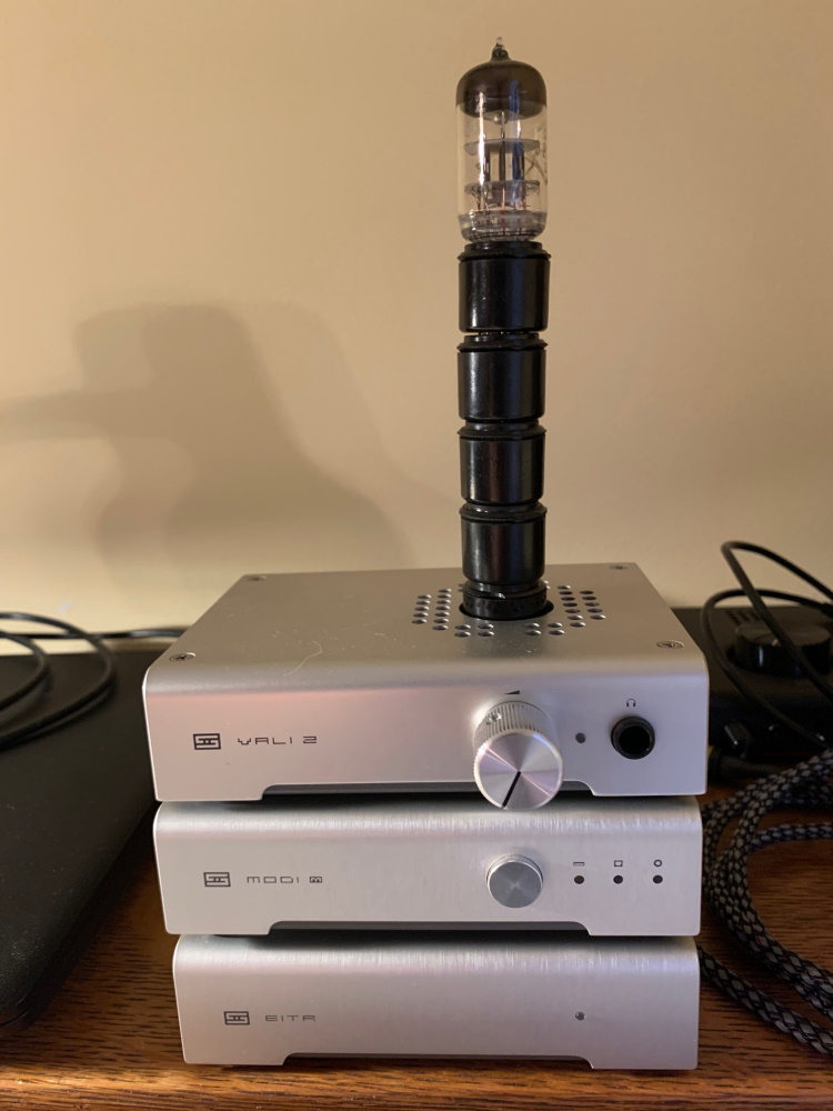

If one socket saver is good, more must be better. Right? :) :)
