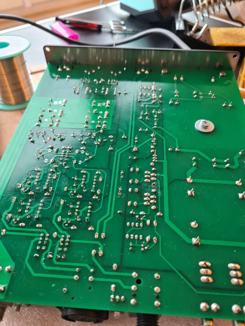

You won't believe it.
I used some 8 Pin dip sockets out of my stash, I don't know how old but probably one of my aliexpress 100 piece orders years ago.
I wanted to replace those and trimmed the leads down to absolute bare minimum. That was it. The pitch is gone, even with the crap sockets.
Edit: Pete answered, what an awesome guy.
I have this same problem but it is only on my pre-amp out put. and only when I use the High gain switch.
I didn’t use sockets but trimmed all the leads down but that didn’t fix anything.
was there anything else that you did that helped?
Aug 18, 2023 at 5:04 PM Post #141 of 144
I actually tracked the issue down to oscillation caused by bad solder joints, not only the sockets but at some other points as well. I would suggest to reflow everything that looks fishy, or completly every thing until you have proper solder joints. Also look from the top of the board if you can see the solder coming up to know that a solderjoint is properly.
