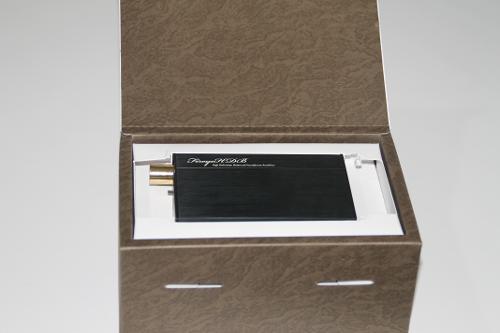

Packing & Accessories:
Not much to say here. The new HDB comes in just a nice paper box. Inside you'll find a 4-pin to 3.5mm single-ended short cable, a DC 24V/0.5A adaptor and 3 extra DIY 4-pin plugs. The short cable is of excellent quality as expected from FSA cables. It would've been nicer if there was also a single-to-single cable as well, and at least a carrying pouch or case.
Build & Design:
Build quality is simply perfect. The whole amplifier is made of aluminum, rather thick and feels very sturdy. The gold painted volume knob is plastic and so are the 3 switches. In the front side we will find the Gain switch along with the volume knob and the two different headphone line outputs, single 3.5mm and 4-pin balanced ended. The single output can accept both TRS single and TRRS balanced plugs (such as Hifiman's in-ear models). At the rear side, the Power switch, the charge input and the both line inputs, 4-pin balanced and single 3.5mm, with a switch to change between the inputs, and the charging indicator LED. As for the 3 switches, they might be rather small, but not fragile. The Gain switch goes from Low (middle position) to Med (up) and Hi (down). Personally, I think it'd be more logical to put them in order rather than having the Low in the middle.
As for aesthetics, my credits to FSA for the simple yet elegant and beautiful design. Not the lightest weight unit, but easy to carry on the go nevertheless.
Build & Design:
