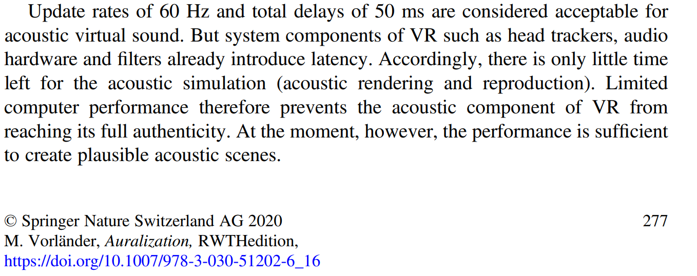

Latency will probably ultimately kill this idea in practice. I've hear head tracking for audio requires sub 10 ms latency to work well and there probably isn't a way to achieve that without real time kernel.
I'm worried about that too. According to these two papers, a total system latency of about 50ms seems to be acceptable. But a Bluetooth head tracking system could take up 10-15ms. And copying audio stream from VB-Cable to headphones takes 8ms with the fastest audio repeater kernal mode. Not to mention BRIR impulses are often quite long. The timing is indeed tight.
I assume if you don't move your head too fast, only slowly, then it would be all right?

Just got a chance to try out my first prototype of head tracking. I didn't have the time to measure my own HRTF for now, so I used some generic ones. I haven't done any rigorous measurements or optimizations yet, but the latency seems to be quite acceptable. I can hardly notice it unless I'm turning my head really fast. It's possible that the use of generic HRTFs might be affecting the localization quality, making it harder to discern any latency.
