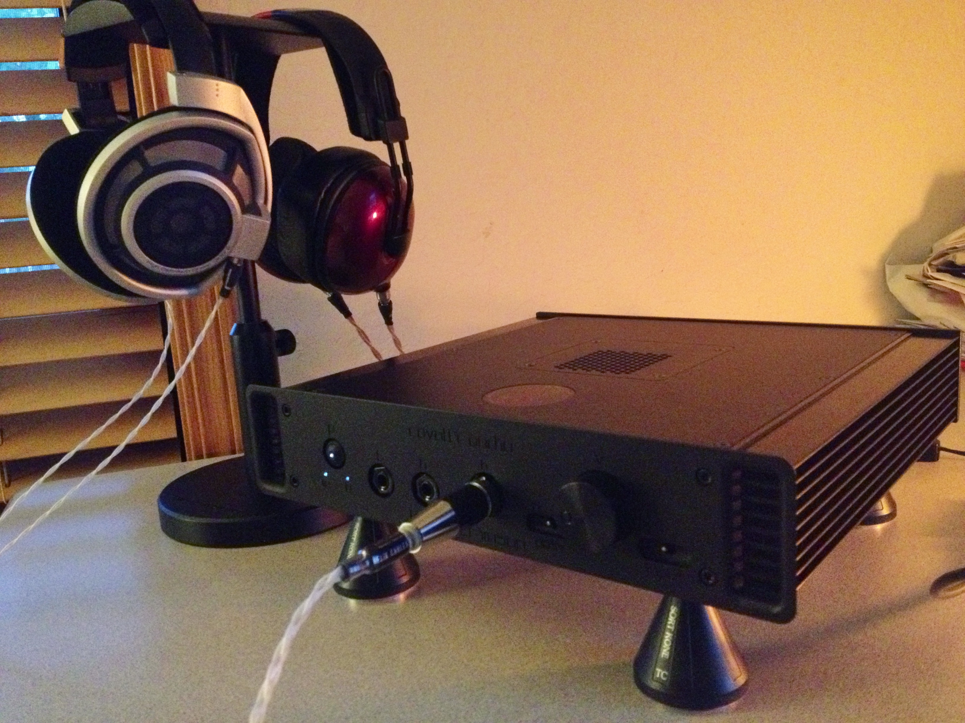

The new Liquid Crimson by Cavalli Audio.
More info on Facebook. And full specs + details to be announced later today.
Alex let me have the opportunity to audition this one, and I think it's pretty fantastic. It has that great Cavalli House sound, detailed yet absorbing. This one has that special ability to be musical to my ears without the expense of detail, or added coloration in any way. It's just pure music.
