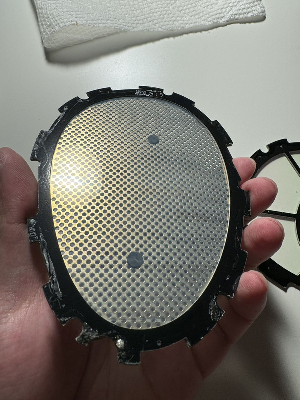

By the way, this seems to be normal on non-STAX commercial estats? The pictures below show the Jade II & SGL SR that I disassembled. Hifiman added plastic discs to their stators to clamp the diaphragm to prevent it from sticking to the stators...

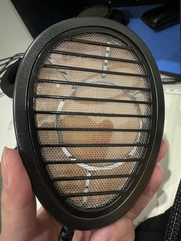

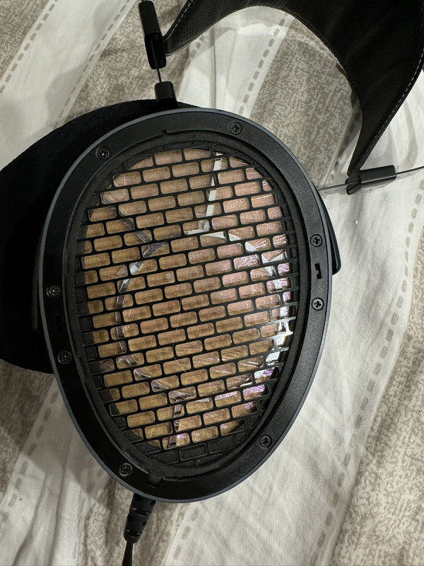

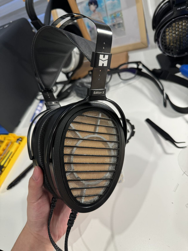

Hi guys, I'm new to DIY. I would like to say thank you for the valuable posts here, especially HifiXMen, who answered quite a few of my questions. Allow me to share with you my DIY SHANGRI-LA project below.
First, I own a pair of Jade II headphones. While I appreciate the Jade II's treble, I have some concerns about its bass performance. So I decided to blue-tac mod it, and after sealing it, it improved the bass response significantly, to my great satisfaction. One day, however, the left channel of my Jade 2 suddenly became almost inaudible. After careful inspection, I found no problems (it was only after the modification was completed that I discovered that the cable was broken). At this time, a bold and interesting idea came up - why not transform it into Shangri-La?
For this modification, I chose to use 325 mesh copper mesh as the stator material and directly pasted it on the Jade II dust cover stator. I kept the original Jade II diaphragm because it offers better stability. Additionally, I cut some 0.3mm PVC sheets to widen the DS gap to 0.8mm since the original DS gap was only 0.5mm.
Finally, I replaced the original headband and grille with Arya's, making it look and sound strikingly similar to the Shangri-La. (Sonically, it's less aggressive and warmer than the SHANGRI-LA. There's excellent soundstage and detail, and the bass extension is pretty good, but it still lacks punch for me.)
For the dust shield, I used 0.5u mylar, which I rolled out and glued on, but I seem to have screwed it up
. But thankfully it produced no unwanted noise.

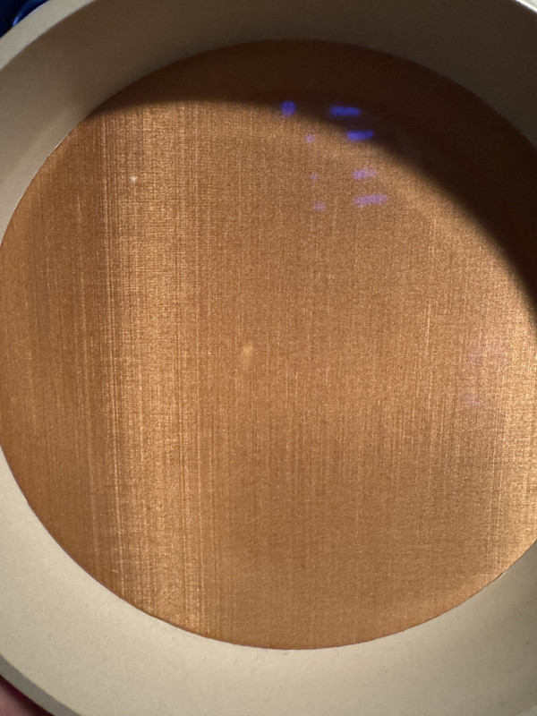

Is it comparable in sound quality to the stax 007 MK2?Here is the diafragm and the stator
ts8051
- Mar 22, 2017
- 102
- 17
Hello, excellent stator. Please let me know where did you find the material of the stator. I suppose that you cut it to the shape by hand and not cnc machine
Hi, If you mean the mesh stator material, then they are here!Hello, excellent stator. Please let me know where did you find the material of the stator. I suppose that you cut it to the shape by hand and not cnc machine
https://www.amazon.ca/AMPSEVEN-Tami...BPRl1UCSpB20tHgBin4xOOmThx-SLJ4iQRXl3H-NKjxP_
