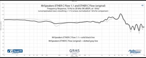

Located this attached frequency response curve from the RMAF video posted by Jude. 1.1 represents a nice improvement for the ECF, notably cleaning up the drop around 180 Hz.
I'm still rolling with the white pad post 1.1 update. As someone previously mentioned, it restores the warmth of the classic Flow sound signature post update, but still preserves the newly implemented transparency. It really does feel like a veil was lifted from the sound.

The dip in the ETHER C traded more bass for a bit of a hole in the upper bass. This reduces the harmonics to the bass, which IMHO gives a lot of life to the bass, plus it's more coherent sounding so the bass sounds more convincing.
Happily, if you want the increased soundstage but prefer the original bass you can remove the bass vent patch and just use the new driver damping to increase soundstage and clarity. The upgrade is reversible and for the closed there are two parts to it; you can use either or both.
