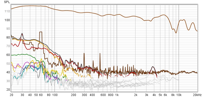

Sep 22, 2023 at 6:39 PM Post #5,153 of 5,620
Distortion measurements:
Finally, for interest, here are some distortion measurements using these in-ear mics with REW. The in-ear mics were connected to Earfish's included Axagon USB HQ Audio Mini Adapter while the test signals were being fed to the headphones through my FiiO K9 Pro ESS. The measurement length was set to "512k". Today amid the odd decrease in mic sensitivity, the noise floor had also decreased to around -50 dBFS, whereby resting my right hand on my DAC/amp's chassis somehow decreases that to -65 dBFS or lower. This is amid an ambient 35 dBA noise floor.
Meze Elite hybrid pads - 98 dBA unsealed playback:
The 98 dBA figure comes from holding my HT-80A SPL meter up to the driver with the wind shield on and using REW's "Measure" feature's "Check levels" button. The DAC/amp was set to low gain with the volume knob a bit past 3 o'clock compared to the a bit past 5 o'clock maximum. The THD in the midrange is upwards of -68 dB, or around 0.04%, which is excellent. To put this into perspective, I get this same 98 dBA when playing back the opening of Mahler 5 at the nigh concert levels, so this headphone is very much under control. Likewise, the subbass distortion is on the order of -54 dB or 0.2%, which is surely inaudible. Nonetheless, you can see the peak in distortion around 370 Hz where a supposed driver mode causes a shelf in the response.
Meze Elite angled Alcantara pads - 98 dBA unsealed playback:
Here, bass distortion is only slightly lower due to lower bass levels, though the relative percentage THD would be slightly higher. I will continue to argue that the hybrid pads are superior for EQ due to their better sub-bass extension, and the phase response doesn't suggest anything advantageous about the angled Alcantara pads.
Meze Elite hybrid pads with measurement-enhanced V3 EQ - 98 dBA unsealed playback:
Not much interesting here other than the occasional distortion peak, and that EQing up the midrange toward neutrality was not detrimental to the distortion performance.
Meze Elite hybrid pads - 111 dBA unsealed playback:
This was with the DAC/amp set to high gain with the volume knob set to around 4 o'clock compared to the a bit past 5 o'clock maximum. Of course, the in-ear mics provided reasonable isolation for my ear drums. In quite good control, peaking at -54 dB 0.2% THD in the upper bass (around the same level as at 98 dBA playback!), going as low as -58 dB or 0.126% THD in the upper midrange.
Meze Elite angled Alcantara pads - 111 dBA unsealed playback:
These pads seem to suffer less from the 300 to 400 Hz driver mode distortion, the distortion performance otherwise being similar.
Meze Elite hybrid pads with measurement-enhanced V3 EQ - 111 dBA unsealed playback:
Here, the upper midrange which was EQed up toward neutrality goes up to -52 dB or 0.25% THD.
