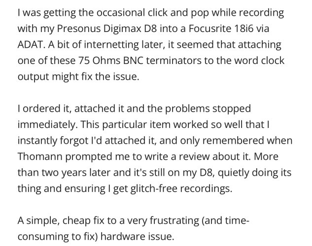

One person had ground issues and it solved the pops and clicks sound.
He used it for the word clock

Dec 28, 2022 at 2:01 PM Post #400 of 3,829
You're welcome :P
