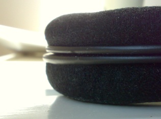

Just bought these classics (DT 990 - 600 ohm), replaced the earcushions and the headband (diy leather
), and I was ready to go. Wow, do they sound great. Real bang for the buck, if you can find a pair.
If you guys are using the original earcushions, do yourself a favour, and replace them. It´s a completely different phone after you put the new ones on. The old foam deteriorates, and is no good after 20 years.

I tried new 990 cushions (well, a couple of years old, but still...) and restuffed the original cushions, and found the re-stuffed old cushions more balanced, albeit less airy. The balance was too much towards treble with the newer cushions.
YMMV obviously.
I love these things, much prefer them to the 990pros that they are replacing - what's lost in airiness and bass is more than gained in balance, although I've yet to power them with a good powerful amp, which I believe they really need.

In my pair the old cushions were totally flat, so I had to get new ones. I do like the open and airy sound from the new ones though
How did you restuff the original cushions? Did you cut them open, and sew them up again, after restuffing them?

Mine were flat as a pancake too! I cut across the gauze on the back at 12 o clock and 6 and stuffed in some stuffing material that my wife had - nothing special, just a synthetic stuffing, looks a bit like cotton wool. Cutting two holes I could stuff it in quarters - a perfect distance to get the stuffing in easily and in a controlled way. I should stitch them at some point, but the stuffing is not going anywhere, the shape of the cushions is not affected and the cuts are hidden, so for now they're fine.
You could cut proper new foam to put in and that would be a more professional solution, but I've no idea if it would sound any better than mine.

I put some pressure on the new earpads for 24 hours. That gets the drivers a few millimeters closer to the ears, and the result is a darker sound and a better bass. Wearing them while you are listening to music will of course get you the same result, but if you are impatient, this is the way to go
I also made a new headband, that´s way better than the original, and the first one I made. Great sound and Great fit. Now we are seriously in business!!

Thanks "Calypso" for the great ideas on the earpads and the headband replacement the pictures are great of your DT990's, seems like you really "love" them to put work into them like this, so they will fit and sound great. Happy Listening.
