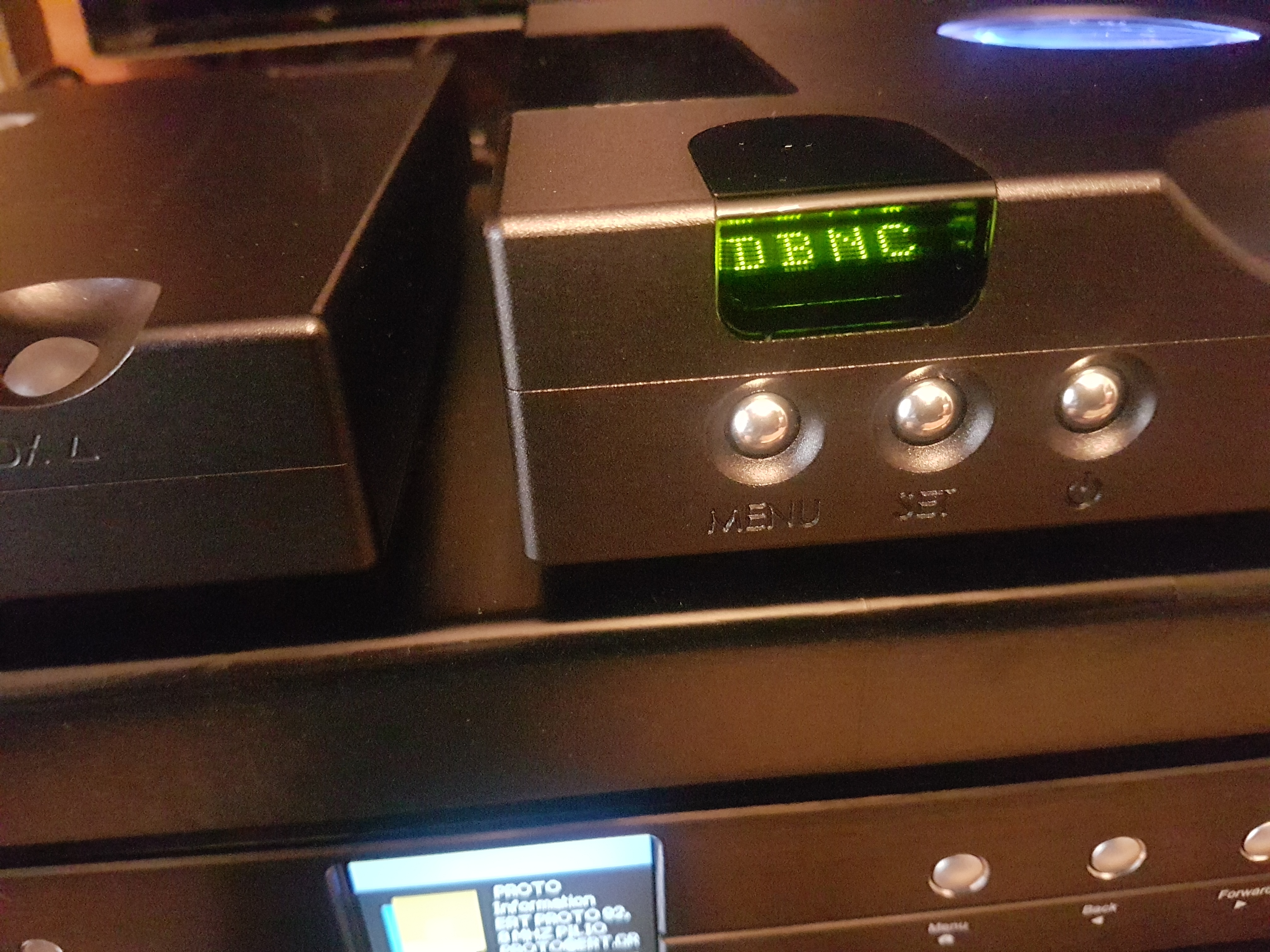

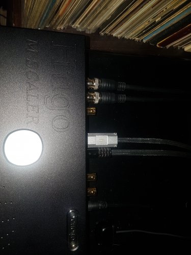

Try power off TT2 and MScaler connect both BNC cables ... connect source to MScaler .... power on MScaler ... wait a few seconds for MScaler to start up ... power on TT2 ... select BNC 1 on the remote ... see if that helps ...
I did exactly the procedure you described, but it did not work.
Try what @The Jester just said. If it’s not working, I think you should have it hooked up the way you think is correct and with everything turned on playing music and the setting you think is right and then take a photo and post it here so we can see if the problem is an incorrect connection/setting or if you just don‘t hear a difference.
The first screeshot shows the song I have selected. In the next two the wiring and the front panel of MScaler and tt2. And at the end a video. Do you see something wrong?
