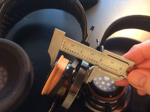

I next compared other cup dimensions by setting a caliper to match the dimension on one headphone cup and photographing the caliper at that setting upon the corresponding dimension of the other headphone cup. Hence, in Fig. 4, the diameter of the light-colored maple wood cup of the PS2000e cup on the left is captured on the caliper that compares that dimension on the maple PS1000e (right), showing that the wood cup of the PS2000e has a larger outer diameter.
Fig. 4: Diameter of the wood cup of the PS2000e (left) is captured by the caliper held against the PS1000e cup, showing the larger diameter of the PS2000e cup.

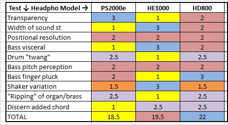

Grado PS2000e / HiFiMAN HE1000 / Sennheiser HD800.
The HiFiMAN HE1000 and Sennheiser HD800 are my best headphones, nearly universally accepted as great. For each, as for the Grado, I built a signal chain based on manufacturer recommendations of choice of DAC and amp, so these comparisons were for entire chains of DAC/amp/headphone.
For the HiFiMAN HE1000, I used the Schiit Bifrost multibit DAC and the HiFiMAN EF-6 amp, optimized for the hard-to-drive HiFiMAN HE-6 and which I found in other comparisons to be the best amp for the HiFiMAN HE1000 (of those that I had available). I ran this in a balanced configuration (the Grado chain is single ended).
For the Sennheiser HD800, I used the Sennheiser HDVD800 DAC/amp combination, sold by Sennheiser especially for the HD800 headphone (and optimized by listening panels during its design to best drive the HD800). I further upgraded the chain with a Norne Draug 2 cable replacing the stock Sennheiser cable, running in a balanced configuration.

Fig. 16 shows the micro tests on 10 acoustic features, comparing the three headphones. The Grado PS2000e excels in transparency, but the HiFiMAN HE1000 excels in sound stage, visceral bass, and treble detail measured by shaker variation. The HD800 is so strong across all 10 features that it ends up winning the highest ranking score.
Fig 16: Micro tests show that while the HE1000 wins the most top honors, the HD800 has the best all-around standing in the 10-feature rankings.
