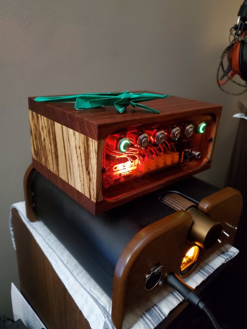

Geshelli sent me the bigger size aluminum case, the same they use for the Archel 3 Pro. They also offer larger face plates for the DACs. This takes care of the difficulty everyone had with sliding it back in. Email them. They're super sweet. You still need the extensions like the Burson ones but it's MUCH easier to set up now.
I have the J2S4499EX with Sparkos dual SS2590 opamps on the XLR ourputs and the RCA output in the J2. The XLR ouptut is going to the Erish 3 Pro and the RCA is going to the FosiV3 amp which is running the dual SS3602 opamps. Seriously incredible desktop setup. Wild sound in such small package. VERY clear, amazing sound. Great with eveything I play. IEMs and headphones. Drives everything I have with no problem.
I've found a trio for my end game desk top set up that I truly doubt I will ever ghange. I like variety and am not always in the mood for the same sound. 1 - The afformentioned Geshelli stack, 2 - the Audio-GD R28 NOS (which is amazing btw), and 3 - the Chord Hugo 2. All three do different things but to me are equally incredible in their own worlds. I say that to show you just how amazing the pairing of Geshelli J2S 4499EX + Erish 3 pro with Sparkos dual SS2590 all the way though sounds to me.

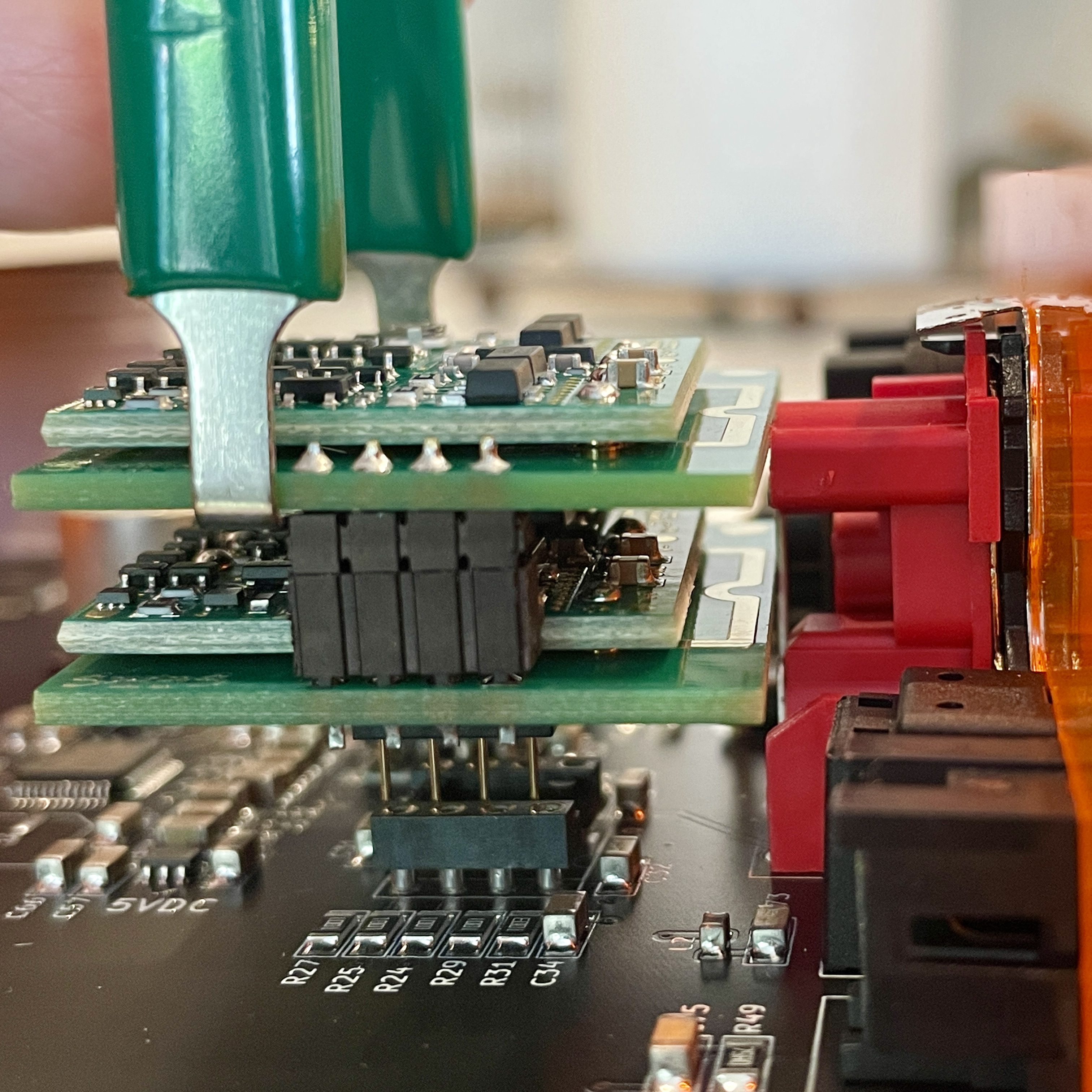

Having enjoyed my recently upgraded J2S (AKM 4493/TI -> AKM 4499EX/Sparkos SS3602), I wondered about what the Sparkos SS2590 might bring to the picture. Already, I found the new AKM DAC and SS3602 to deliver much improved dynamics and greater soundstage depth than the previous configuration, both of which being immediately noticeable. Since then, I've seen a few install a dual SS2590 with DIP8 adapter on the single ended RCA output, which is easy to do. The only caveat I might offer is I found the fit on my board socket was not snug enough for my liking. I rectified that by first inserting a DIP8 adapter socket and the SS2590 into that. This improved the fit in my case, YMMV. The thing is, I use the SE output mostly to accommodate an xDuoo-TA26 tube headphone amp. I used balanced XLR for everything else.
Getting the dual SS2590s to fit the XLRs is more of a trick and Geshelli will (wisely) tell you it doesn't work. I was able to get the front unit to work by first inserting a DIP8 adapter, which raised the SS2590 enough to clear the two small radial electrolytics that otherwise interfere. All good there. The rear unit was the problem, but I was just able to make it work with a DIP8 extender (Ali Express or Ebay) and some careful bending. Because the top of this dongled SS2590 tends to brush against the J2S case, I placed a large square of Kapton insulating tape to guard against any possibility of electrical contact. Reinserting the board into the case needs to be done very carefully while inspecting to see that good pin contact is maintained at all points in that arrangement until the board is in place.
As for the results, let me just say that I was happy with the SS3502, but the SS2590 instantly delivers an additional, clearly audible improvement. What's the difference? Right off the bat I'm observing even bigger punch, dynamics, and greater bass weight than the SS3602 with more vivid transient clarity. If I had to do it all over, I would opt for the J2S with the default TI op amps and go this route. This is most likely the best configuration the J2S can be.
I went that route (balanced only) SS2590s and took the advice of a fellow poster and asked for the larger case. The larger case from Geshelli made this very easy with the flexible socket extenders formed to sit down in the appropriate openings. The weight of the dual chips was well supported by the wire cables of the extenders from making contact while providing a low profile able to slide out of the case with no issue. Stability support was provided by using small pieces of foam to wedge between the chip and supported by a nearby (non hot ) component on the board. As for the sound it is right on par with your specific assessments as I compare it to my other dacs. Greatly improved sound quality to my listening space and ears.
