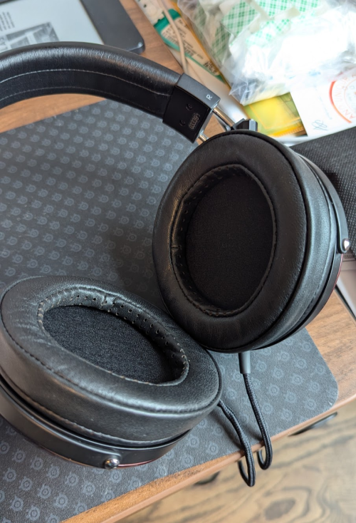

Lawton mod mod
Do I get it right that the original Stax SR-009 pads are protein leather, but there are also even more expensive real leather pads available?
The reason why I'm asking is that I'm not a fan of protein leather pads.
I am not a fan of the protein leather either. so I did another mod.
This time I took my Lawton sheepskin angled pad and applied Zolkies mod.
This needed a different, but also not really difficult aproach as you can see on the pics.
I definitely like the sound of the Lawton pad mod better than the original Lawton pads.
But since now I have quite a range of pads and cables to compare (around 20 variations) it will take some time until I will post (my personal) results and prefrences.
Nov 17, 2020 at 1:34 PM Post #327 of 351
I have the same kind of Lawton pads. Not among my favorites. You could try trimming the carbon foam insert a little more so that it's not such a tight fit.
My favorite size is rather small on foam inserts, maybe 16 mm high on the back and 8 mm in the front. Of course YMMV.
Nov 25, 2020 at 3:16 PM Post #328 of 351
I tried and indeed smaller (less height) inserts are better. The music is somewhat more coherent and intense with smaler inserts. This might be another explanation why the Lawton pads didn't impress me. They are thicker than the original pads.
Thanks!
