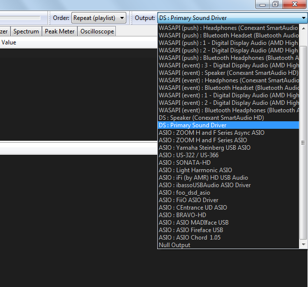

Mar 15, 2013 at 8:40 AM Post #9 of 20
Old topic, but still useful question.
I would appreciate assigned buttons in Foobar to switch between devices as I was frequently switching output devices, recently.
Check this (old) forum out:
http://www.hydrogenaudio.org/forums/index.php?showtopic=81466
In brief: There is not a solution, but:
- Holding shift + clicking on "playback" in the toolbar will let you change the output device as well.
- Simply, leave the preferences for the output window open on the side of screen or a different one.
- Use 2 portable installations of foobar - both identically setup, except each is set to a different device.
I have tried to assign a shortcut to the device, but it will always return a null device instead.

Jan 12, 2019 at 12:14 PM Post #12 of 20
Even after 12,5 years this topic is relevant. I wonder if the initial poster ever found an answer or is even still interested, but I had the same question today and found this topic. It did not give me the final answer but it did point my nose in the right direction.
In Foobar2000 v1.4 (and maybe also in earlier versions) you can go to Preferences > Keyboard Shortcuts. Then add a new key, position your mouse in the "Key" input field and press the key combination you'd like to use on your keyboard. In the "Filter list by" input field under "Action" enter the word "Output" and then select the device you want to be activated by this shortcut. Repeat all this for the second device with another shortcut.
When you switch, you don't get feedback, other than the sound (or the absence thereof) from you amplifier or whatever is connected.
Thank you all for keeping this topic alive all those years.
