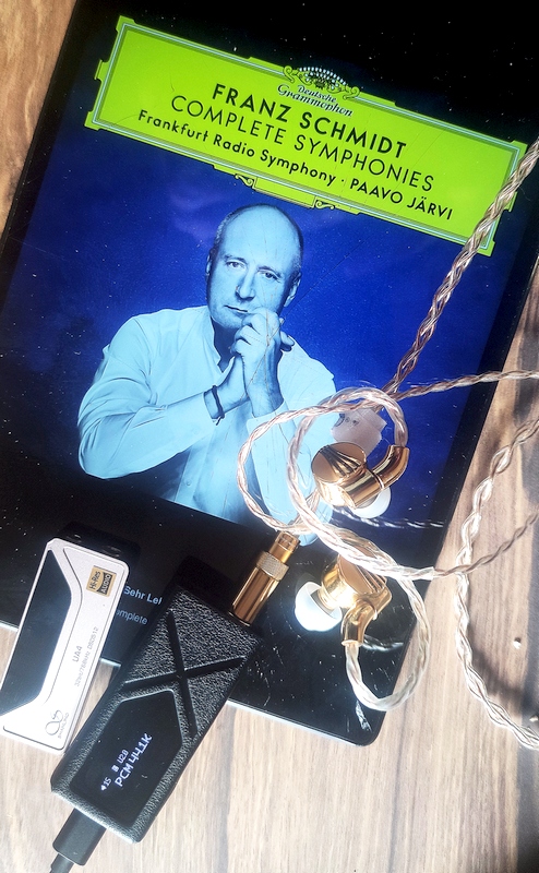

KA17 powered by Anker Nano Power Bank Type-C, driving MoonDrop Para (planar, 8 ohm). Not a bad combination for some really serious performance on-the-go.
