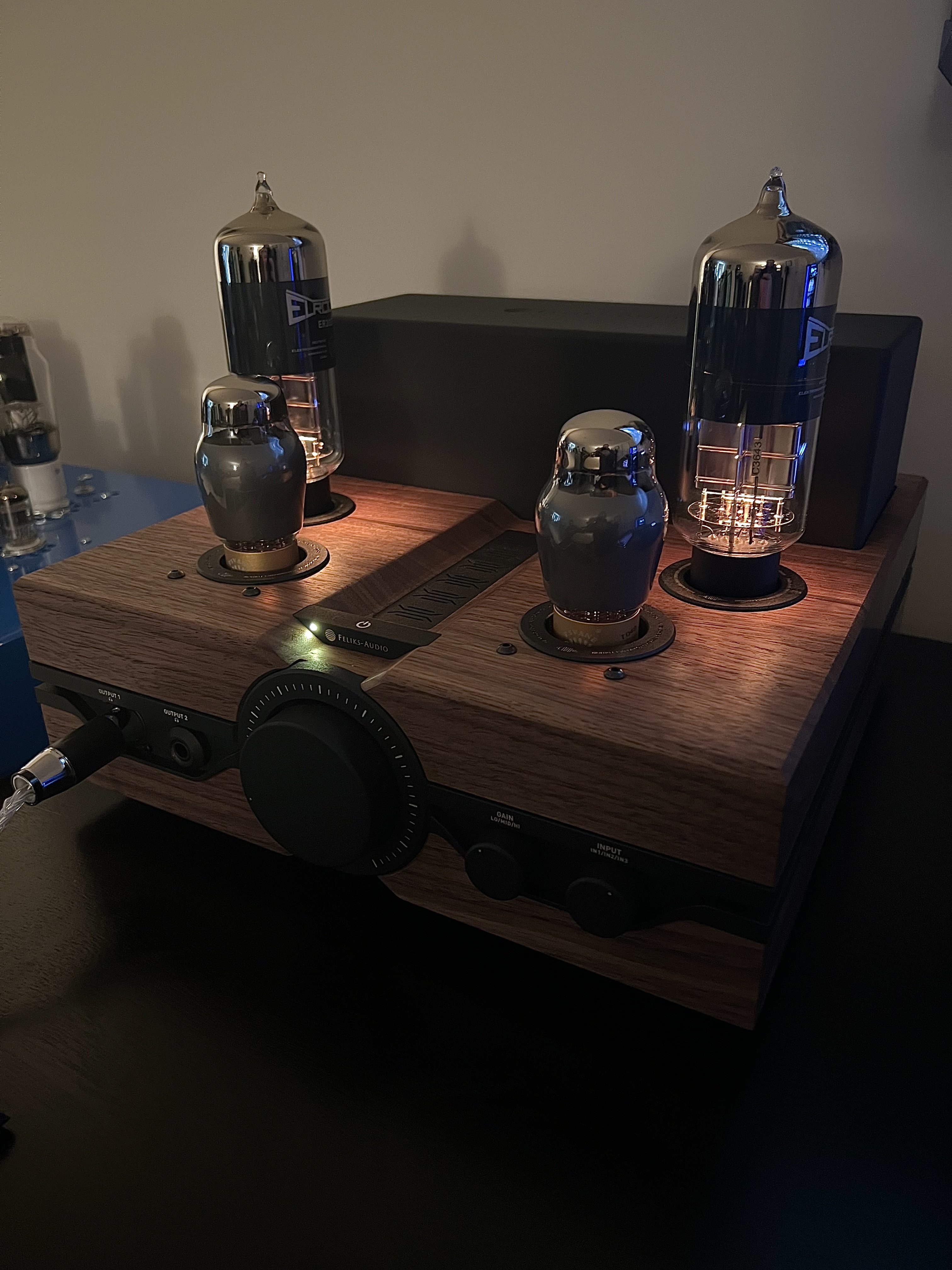

Well went to use the envy this morning and I think a tube(s) failed. Don’t have back ups on hand yet (Elrogs are coming today). Basically turn it on and with the utopia I can hear music but it’s super quiet. Even if I crank the volume all the way up it doesn’t get much louder.
Anyone have any idea on what it could be?

Input select? Due to the audio bleeding it could be that the music is really quite

It’s on the right input. I’m pretty sure it’s a power tube. I can hear it change volume slightly.

Wear your Headphones around your neck (with Pads on your ears) so you can quickly drop them to prevent ear volume damage and have your hand always on the volume knob to move volume instantly. These Tubes sometimes have a knack of suddenly coming into life for a short moment before expiring again.

This seems strange. If a tube went down, I would have expected the other channel to operate normally?
It’s on the right/correct input. Both channels work. The volume is low and won’t get much louder. If the amp was jacked it probably wouldn’t work at all. It’s most likely a power tube. We’ll see today when the elrogs come.

Yeah the dac and Roon is all normal. I used the DNA right after I tried the envy. Streamer, dac and headphones all good.

Had to go earlier and didn’t have time to troubleshoot too much. So I’m home again and with the elrogs. I checked/moved the input to all three positions and have it on 3, for xlr. Elrogs work no problem. I’ll take these out and see if the FM tubes work again. I see what you mean about the inputs. You can hear the music in other/wrong inputs. What’s odd is I leave it on 3 (xlr). Maybe it wasn’t all the way on 3 or bumped? No one touched this so it’s odd. Anyways, amp is good. That’s a relief!
Thanks to all who helped troubleshoot.
