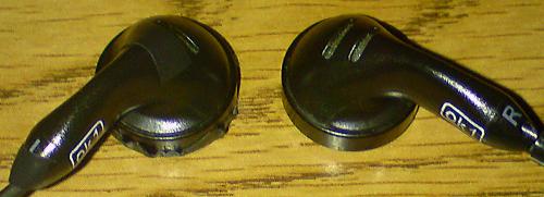

I've been toying around with my OK1 bud finding ways to tweak the sound without relying heavily on EQing. I started applying some passive techniques to attempt better or different results from stock.
The OK1 is an interesting earbud. It is Yuin's top model and an excellent sounding earphone by any measurement. The design starts with a high quality driver that produces quite remarkable sound. It is encased in a rather generic package, but it does hide some technical aspects under it's plain shell. Without actually tearing one apart, I can only speculate on its overall design. The enclosure seems to be a mix of an aperiodic enclosure and a ported enclosure. Behind the the driver there are two foam lined ports that add breathability to the enclosure. There also is a long port that runs along the cable shaft that exists at the base of the earphone. I've toyed with blocking these vents with pieces of tape to toy with the sound, and they largely seem to act as they appear. If you completely block the rear venting, the earphone gets very constrained in movement and low frequency output. Partial blocking to various degrees modifies the sound signature and can tighten up the bass line at the expense of bottom end sensitivity. The port acts largely as a port with added bottom end response open or earlier smooth roll off closed. The vents seem to affect a little higher in the frequency range, even up into the midrange.

My take on simple vent tuning of the earphone. I'm simply using small pieces of electrical tape to partially cover the rear venting and the port.

So what has all of this toying gotten me. Well, the results are interesting but are following expectations. The rear venting has a large effect on the movement efficiency of the driver. If you block too much, it can get rather constrained and peaky. One gain with partial coverage of the rear venting is that the bass does get tighter and more forward, but the gains are in the high bass and lower midrange with a loss of bottom end sensitivity. I have come to like blocking of the smaller slot vent as it does help emphasize the upper low end and low midrange enough to better match the well presented midrange of this earphone, and you get a more forward and even presentation. There is a slight tendency for stock to sound slightly loose/aloof. Blocking the large vent slot takes it a step further and makes for a rather forward midrange and lower midrange with good punch and energy. It is however on the edge of being a little too constrained for the woofer in the lower frequencies, and the lower end does really start to sound constrained. The lower port acts largely as a port should. If you block it, you lose some bottom end. I've toyed with it but find it's better just to leave it open. With the bottom end already being light on sensitivity, I do find all this effort to be a bit wasted without counter effort to the high end. Yuin has made an effort to squeeze out a good amount of low end sensitivity and presence from a midrange and high frequency specific driver. The stock tuning shows that they made a great effort in getting as much low end out of it as possible. I do see gains to be had with covering the shorter slot vent, but that's about it.
The front side has been largely beneficial. I've seen great results with the cotton in taming down the top end. The one Q-tip per cover is a pretty good start in terms of changing the emphasis from the upper midrange and treble down towards the midrange. I've upped it to 1.5 Q-tips of cotton batting and think the end response is pretty well balanced. The sacrifice is some of the top end detail and edge does get lost or a better term, weakened. I feel the trade off is a better one. There could be some effort to carefully choosing the density of the cotton to shape the response some. I do want to say that adding cotton batting like this does decrease the overall sensitivity of the earphone quite a bit. You're blocking a lot of the higher frequencies, and the volume setting does need to be set higher, and wattage requirements go up.
The hole covering is interesting. Blocking either doesn't drastically change the end sound signature. Rather blocking a part is more so an exercise in presentation. I'll break it down into two ways. Having only the outer holes is beneficial in the sense of ambiance. It adds spaciousness to the sound. However, the presentation is less direct and pinpoint. Blocking the outside holes takes away some of that space but also adds some precision to the sound. I'll note the changes aren't massive but are perceivable.
Current setting: 1.5 Q-tips cotton batting, outer output holes blocked, and toying with partial coverage of both rear vents.
