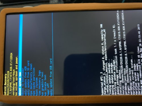

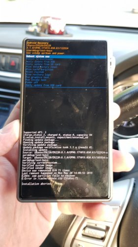

622D9E3F-8A21-4A96-872B-EE0585344F0F.jpeg I am sorry it was online update (not local update). Somehow after installing system update I got this notice:
What should I do next?
May 20, 2019 at 6:29 PM Post #3,575 of 13,489
You could try a factory reset and then do an update again, the OTA. Or download the firmware and use the SD card.
May 20, 2019 at 6:30 PM Post #3,576 of 13,489
I can't read it, but the OTA update didn't work for me this time. So I downloaded the zip file from ibasso website and put it in the root folder of my player and then did the local update. You could use your micro SD card also- on the root file.
May 20, 2019 at 6:31 PM Post #3,577 of 13,489
Oh that's the error I was getting, you have to hit the power button and try OTA again- I tried 4 times or download the zip and do local
