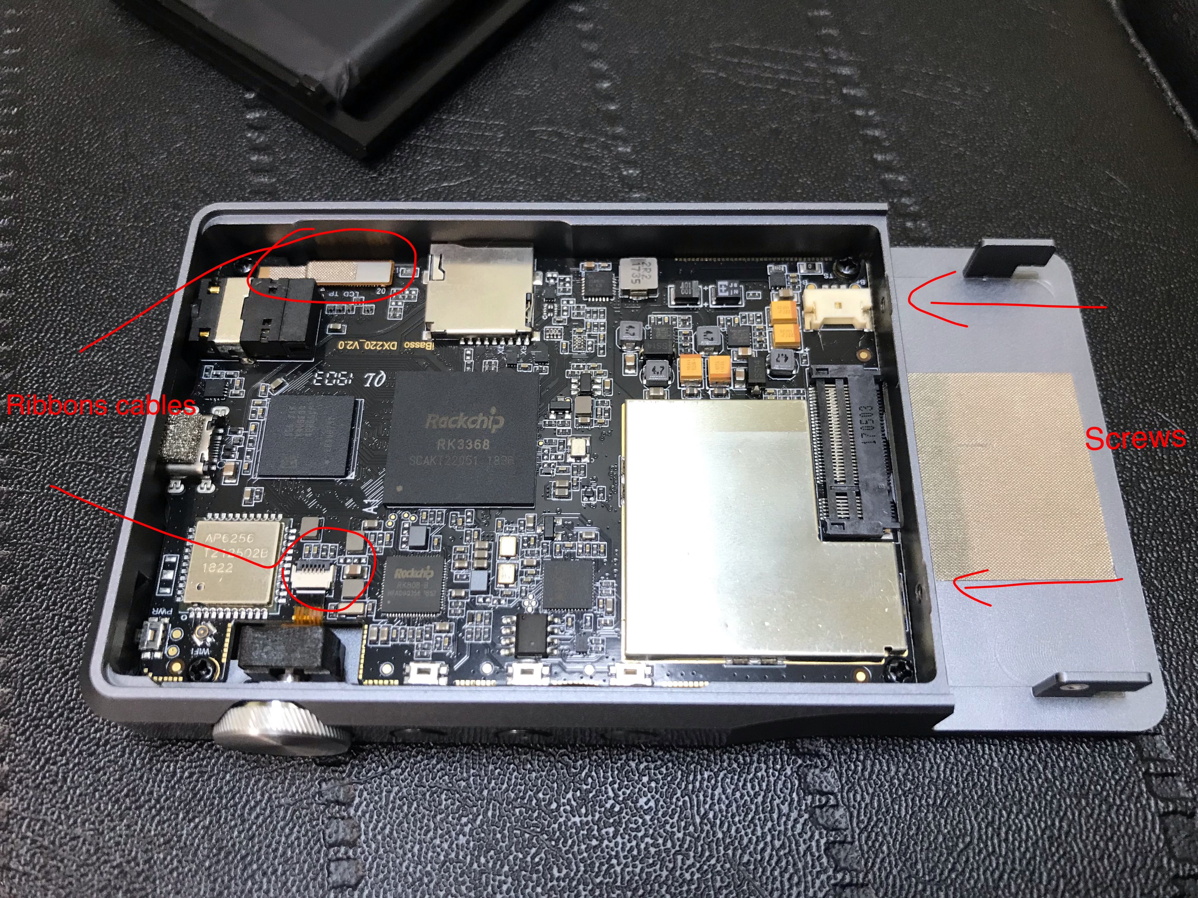

Thank you to @bden59 for helping me to enable the EX modifications for DX220. The goal is to preserve bass slam, timbres density, further enhance them in controls, dynamic and punches, improving clarity, details, trebles extensions.
There will be 2 parts of the EX just like Dx200.
Disclaimer: by modifying your unit, you risk permanently damaging your dedicated player, and you are sure to void the warranty. Only proceed when you are ready to lose your player and take all the risk as a man wearing his pants **. To anyone who can and will perform these modifications, please keep in mind that it was developed for enthusiasts and by enthusiasts, so please keep the labor reasonable.
1/ part 1: Hardware Modifications
You will need
https://www.mouser.com/ProductDetail/80-T543B107K010TE150
3x of those
https://www.mouser.com/ProductDetail/80-T543B227K6AHW35
2X of those
https://www.mouser.com/ProductDetail/80-T520A226M10ANE080
2X of those
https://www.mouser.com/ProductDetail/80-T520A107M006AT
4x of those
https://www.mouser.com/ProductDetail/80-T527I476M06ATE200
4x of those
You will replace a total 15 capacitors and 5 different values
Layout is as in the pictures. Ask if any questions
Tips: in order to open up Dx220, you need to take out the Amp module. There will be 2 screws with 1 under the warranty label. Unscrew then, then use a sucker to split up the back from the side of the 2 screws. It will be a bit tough to get it in and out.
*tape the side buttons up* or else they will come loose and give you some funky business. Remember to take out the MicroSD
After unscrewing 4 screws, and remove ribbon cables (only 2) .... Lift the PCB from the bottom from side to side with a tweezer, be patient as there are cooling thermal plaster which keep it attached to the back chassis. Then push in the SPDIF uptop and take out.
2/ Part 2 is TDK noise absorbing sheets. You will apply it upon IC chips similar to DX200EX
