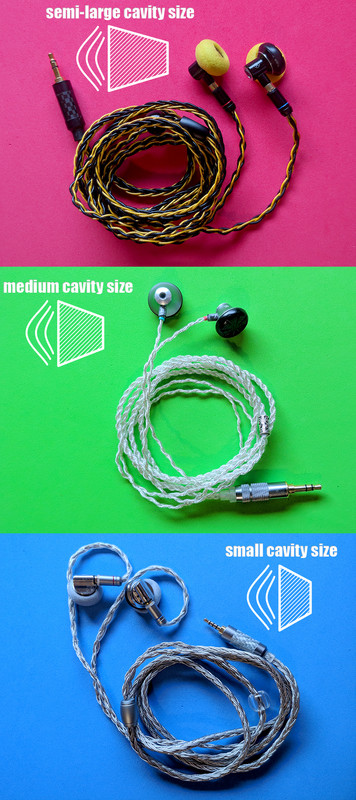

Ok. The next topic/project was inspired by MSUR headphones (N350 and N650).
BTW ... I recently bought theirs earbud MSUR C210 (8mm beryllium driver) and I will talk about these another time.
These two headphone models have one thing in common: Beryllium driver.
I read somewhere that a cheaper model N350 sounds better than the N650 model.
Reportedly, according to the comments, the problem is a different size of the wooden cavity.
This comment gave me the idea to try how individual drivers behave in shells of different sizes.
For this project, I decided to use three metal cases of different shapes and cavity sizes with three 15.4mm 130ohm beryllium drivers.
These are the selected candidates
This topic will be divided into several parts, probably for each size, and the story will be based on:
- pros and cons of shells itself
- design and comfort
- basic modding
- the effect of cavity size on sound
For the last item, I will try to explain in brief the sound difference.
In order to better explain this, I need a few reference songs ie the songs that you guys use to test separately bass, vocals, instruments, treble, soundstage.
So this is all about the intro.
